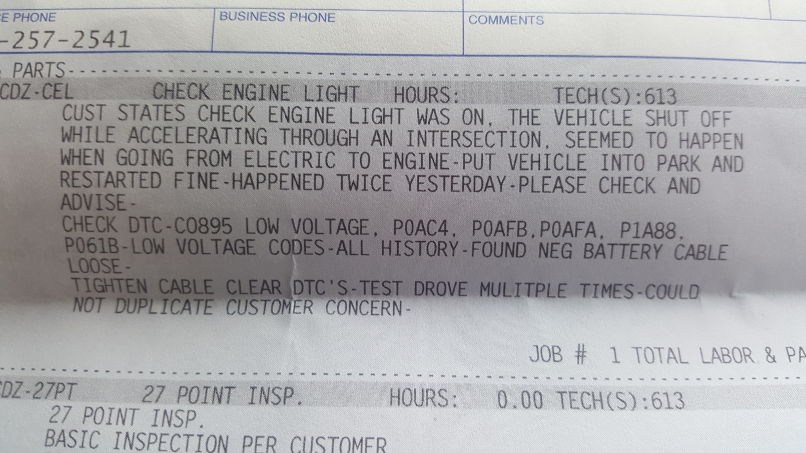

Finally took to dealership and explained everything. They kept it for 6 hours.
They tightened the 12V battery terminals and gave it back. So far (2 hrs) so good.

Dealer ticket...

That would be fantastic if that fixes it. Sometimes, it's easy to get focused on the bigger problem, and we forget...
12V system MUST be in good heath for proper diagnostics.
