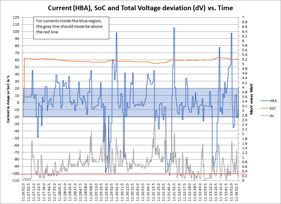

Default Re: Infrequent stalls and sometimes POAC4 and P061B (Battery Data Included)
Please see the attached.
In the Current, SoC and dV chart, you can see that for currents inside of ±20A, the gray line representing the maximum block voltage deviation routinely exceeds the red line (0.3V). This is bad.
Of note is that there seems to be some tendency for dV to narrow as the drive progresses.
In the Current, SoC and blocks chart, I have identified 3 peaks. As you can see the peaks start to clean up as do the valleys as the drive progresses.
Both charts suggest that your pack is suffering from:
  1. Varying degrees of self-discharge (SD) within cells/subpacks. As they sit, even for short periods of time, they lose their charge at high and varied rates.
  2. Gross imbalance resulting from #1.
This level of SD is extremely atypical of Toyota cells/subpacks.
This is typical of Honda NiMH "D" cells (also made by Toyota) subject to extreme heat AND Ford Escape Hybrid cells + heat.
