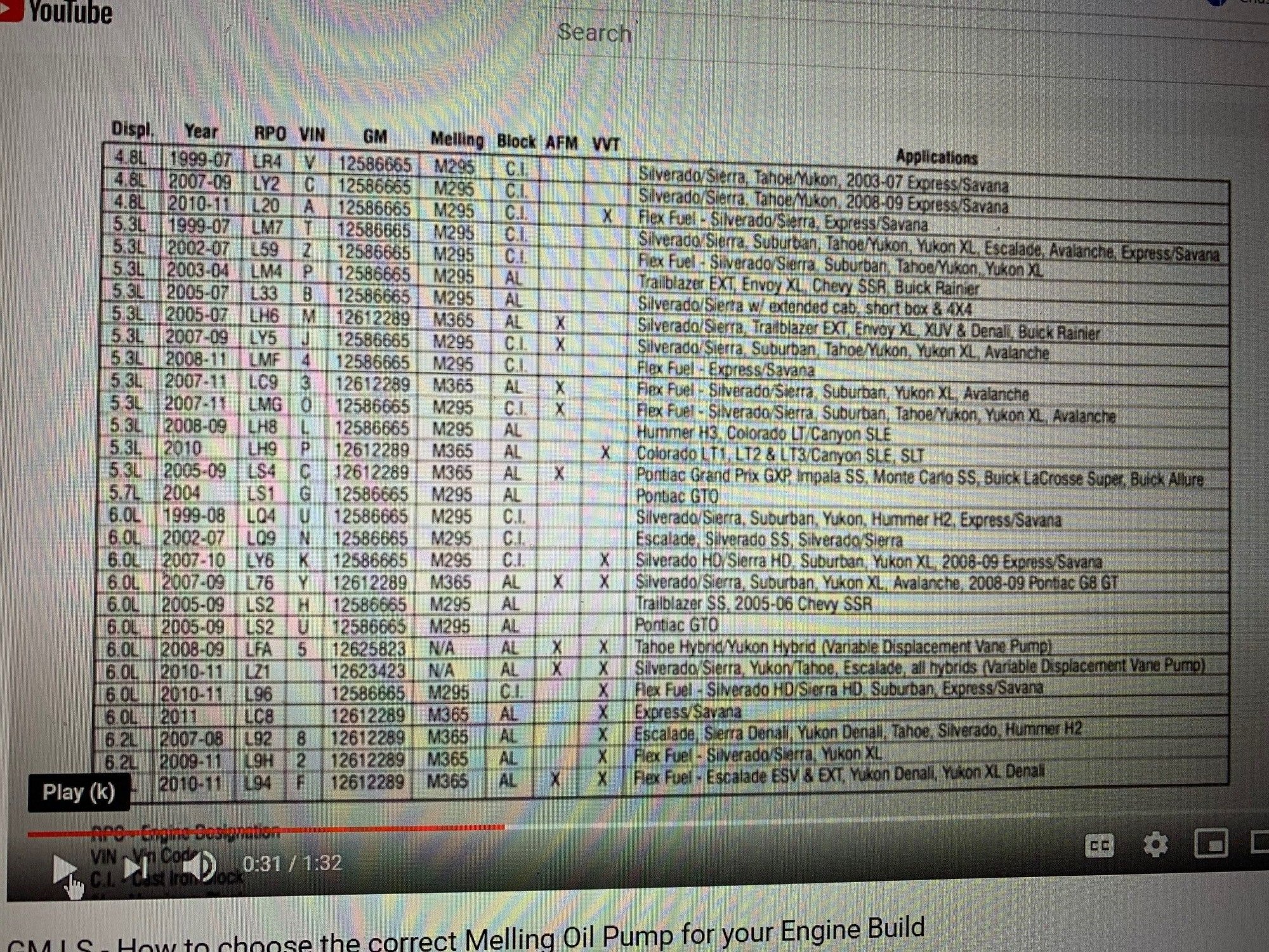

Working on an oil pressure warning and issue on my 09. Determined it was the oil pump pickup O-ring, which is a relatively common problem on the LS engines like in the Hybrid and other GM vehicles. Since dropping the oil pan is such a pain, thought at 200K miles I would change the oil pump too. The LS engines with AFM (4 cyl mode) have specific pumps which have more volume. However when searching for the correct on for the Hybrid, found that Melling (a high quality perfromance oil pump supplier) does NOT have one for the Hybrid, and in the notes states something about a variable displacement vane pump. So does they Hybrid use a specific pump and can the high volume ones for other applications be used? I suspect the variable displacement pump is for fuel economy reasons, like many of the other parts on the Hybrid.

OEM Oil pump for the 6.0 tahoe hybrid. (Mine is a 2009) is 12623423
https://www.gmpartsdirect.com/oem-pa...-pump-12623423
According to my dealer they are different from the normal 6.0 pumps.
