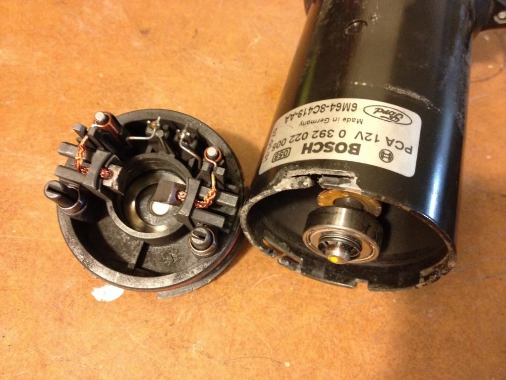

I just replaced original Bosch MECS pump with Dorman pump.
The main difference of the two pumps is: Bosch pump use BRUSH DC motor, Dorman pump use BRUSHLESS DC motor.
Brushless DC motor is much more reliable than brush DC motor. If you already have Dorman pump on your car, you don't need to replace it anymore.
I open the original Bosch pump, there are lot of carbon powder inside the motor and the brush worn out already.

I didn't see any on/off control on the original pump. It's very simple structure, two pins come in from connector, then connect to two brushes and drive the motor.
And there is no shaft leak issue at least on the original pump, motor and pump blade are coupled by magnetic, they are completely separated.
I guess Dorman pump has much simpler structure(that's why it's so small), the pump blade is rotor and has magnetic on it, it must be separated from windings on the other side which act as stator. If that is the case, no leak issue as well.

Motor on Bosch pump
