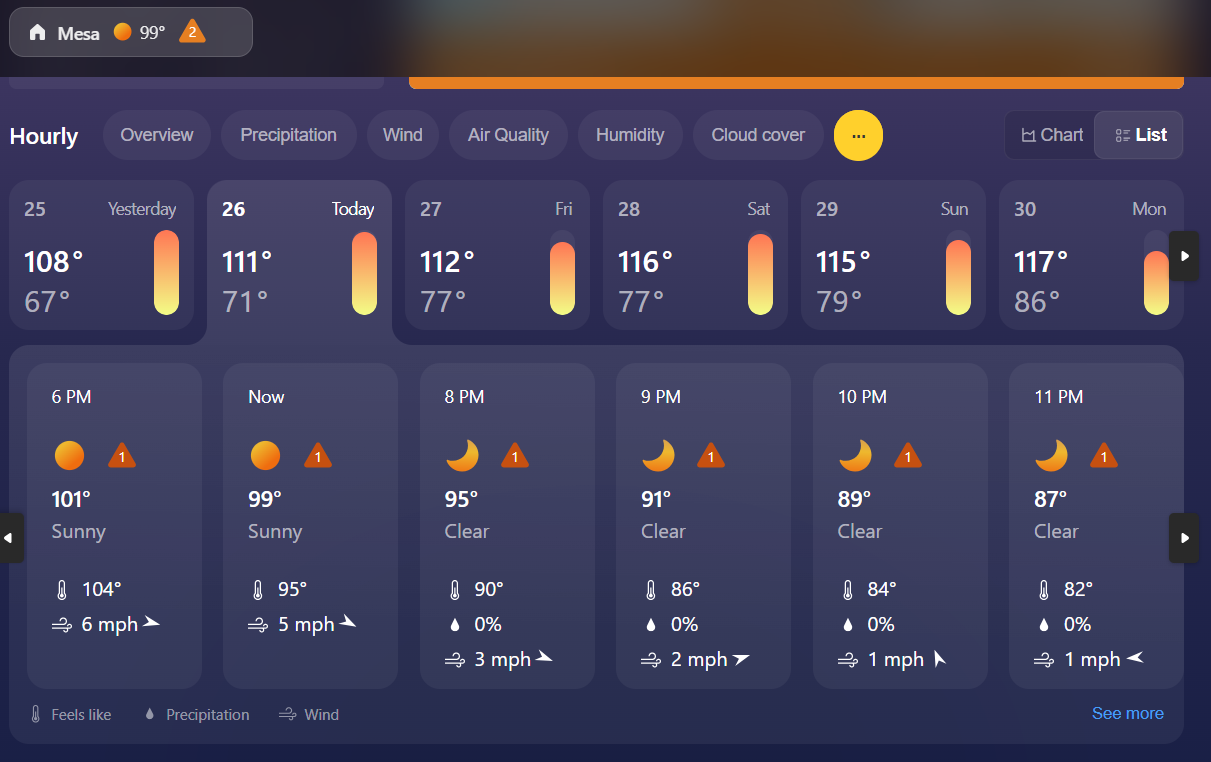

Old Jun 26, 2025 | 07:16 PM
  #34
Default Re: Completely dead even when plugged in to a charger.
I am so jelly.
These are our "feels like" temps.
