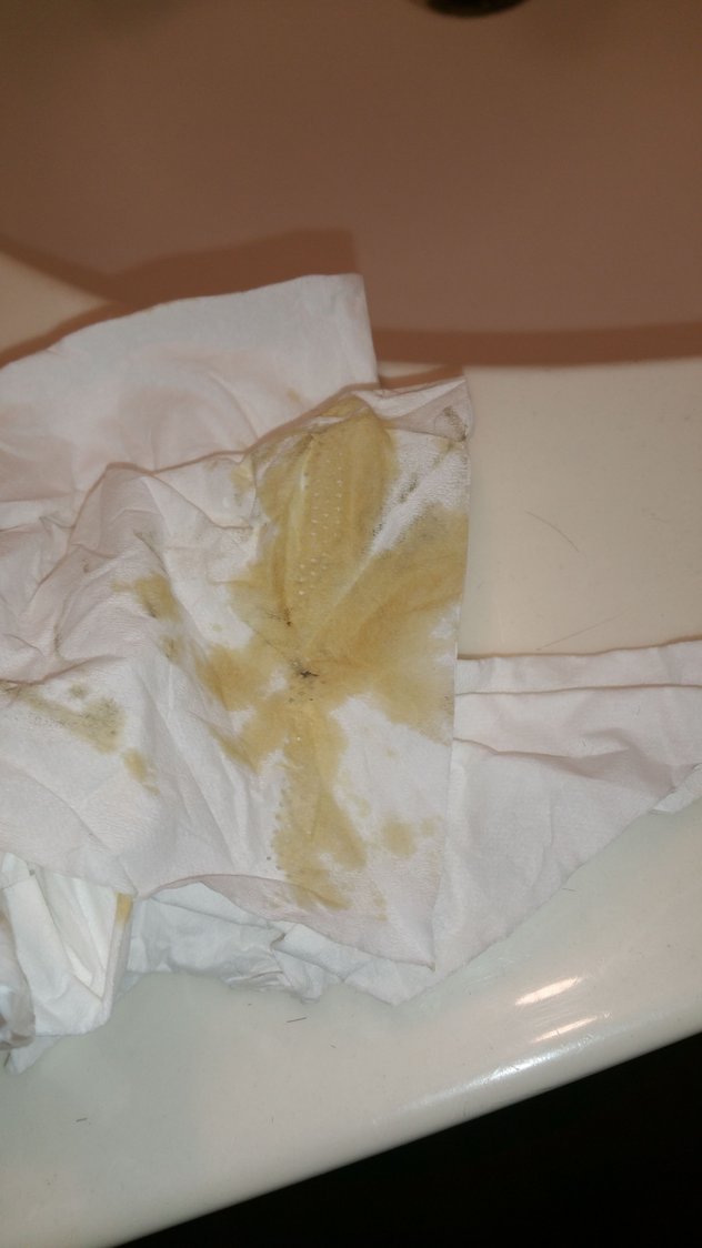

Default Re: AFM issue? getting stuck in v4 mode
it happened again yesterday then was a bit rough between v8/v4 for a little bit
engine oil is clean and full still at 2k miles into the oil change
it worked perfectly fine tell that point
physically undetectable v4/v8/v4 shifts
definitely a mechanical issue
cheap as possible, no the shop will have to pay to have it repaired correctly as they caused the damage.. only using new genuine GM parts
none of this after market bs I prefer them to use the same engine though(i don't want someone else garbage that burns oil,this one does not burn oil) the crank shaft might be damaged as well. ( very faint knocking on start up)...
