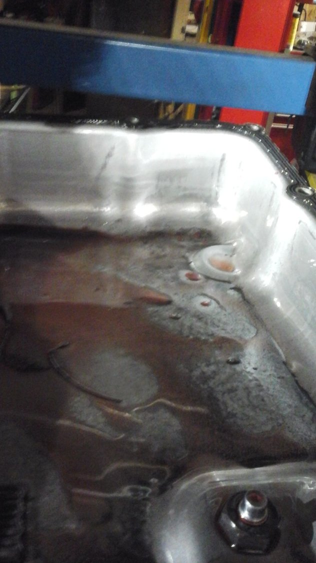

Pulled the pan. The filter is still in place and fluid looks good. I remember when I changed the filter there were fine metal particles in the bottom of the pan but haven't had problems till this one. Wouldn't it show symptoms right away if it was an issue? And thinking about it it might have been 10000 miles ago I think I changed the engine oil twice before this. if i remember correctly. anything else i can check or test to see if it is the whole thing? The engine sounds like it has a slight load on it when I put it into gear but it doesn't move. Sensor some where? Thanks for the help from everyone so far. Hard to find direction on what to look for when the dealership says its shot because the transmission "makes noise when we move it".

Default Re: 09 Tahoe Problem
Welll..... Shoot.
