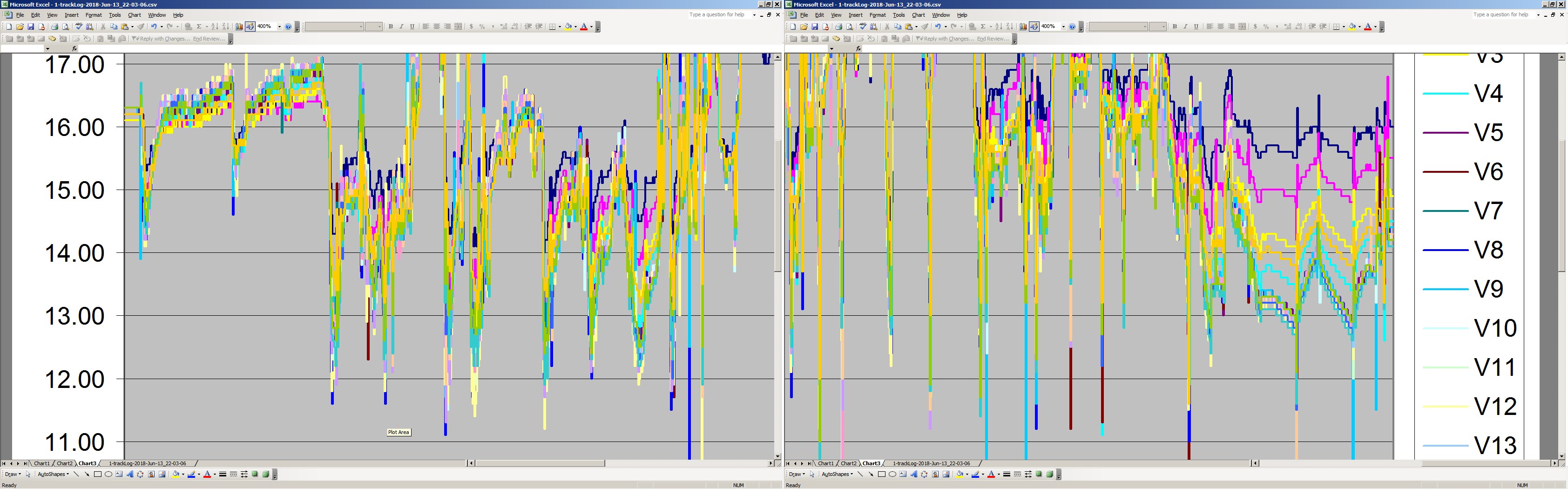

I only looked at #1 so far. The current number is WAY off. Based on expected max/min currents, they may be off by exactly 20X (too big).
"Voltages" shows 20 blocks at start of log and and of log. They align horizontally, so that the voltage labels are the same for both.
Note at the left side, the voltages aren't great, but they're likely around 0.5V spread at the starting SoC of about 70%.
At the right side, the voltages vary by 2-3V consistently where SoC is around 50% - this is atrocious.
"SoC and dV" simply show the total voltage range and corresponding SoC vs. time. You see the same thing here. ~70% SoC = about 0.5V deviation; about 50% SoC = 2-3V deviation.
I'm not going to bother looking at the others. This confirms my assertion that your battery is destroyed. The only way you have even 20 good modules (Hillbilly's 50%) is if every single block has one good and one bad module. This has never occurred in my experience and wouldn't make any sense.
Given that your spread between the top two blocks is about 0.7V at the 50% SoC region, I would estimate that you have 2-3 GOOD modules out of 40. This is assuming the top block has two good modules and the next highest block has 1.
