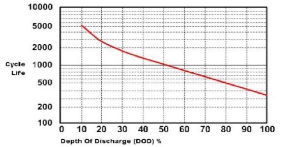

Couple of things to keep in mind. I have an 06 FEH.
If you do really run the tank out of gas, the fuel pump will try to keep running for a bit. This will necessarily be running dry and will damage the pump. I doubt it will fail right away, but it's a notch in the belt that will shorten its life.
My FEH will go about 1-2 miles on a normal charge cycle. When there is no fuel left it can go a bit farther since it can then go below the ~40% of charge engine start point.
But this will run some risk of shortening battery life. In flooded cell batteries that are not made for deep cycling, running it down to parade rest damages the battery and does shorten its life markedly. The reason is the difference in volume of reaction products on each side of the chemical reaction.
The traction battery is essentially a bunch of NiMH dry cells and so I expect the issue is diminished if present at all. But there is a clear reduction in cycle life with depth of discharge. See attached graph.
My take is that one time to parade rest does not seriously reduce cycle longevity. But... don't make a habit of it.
