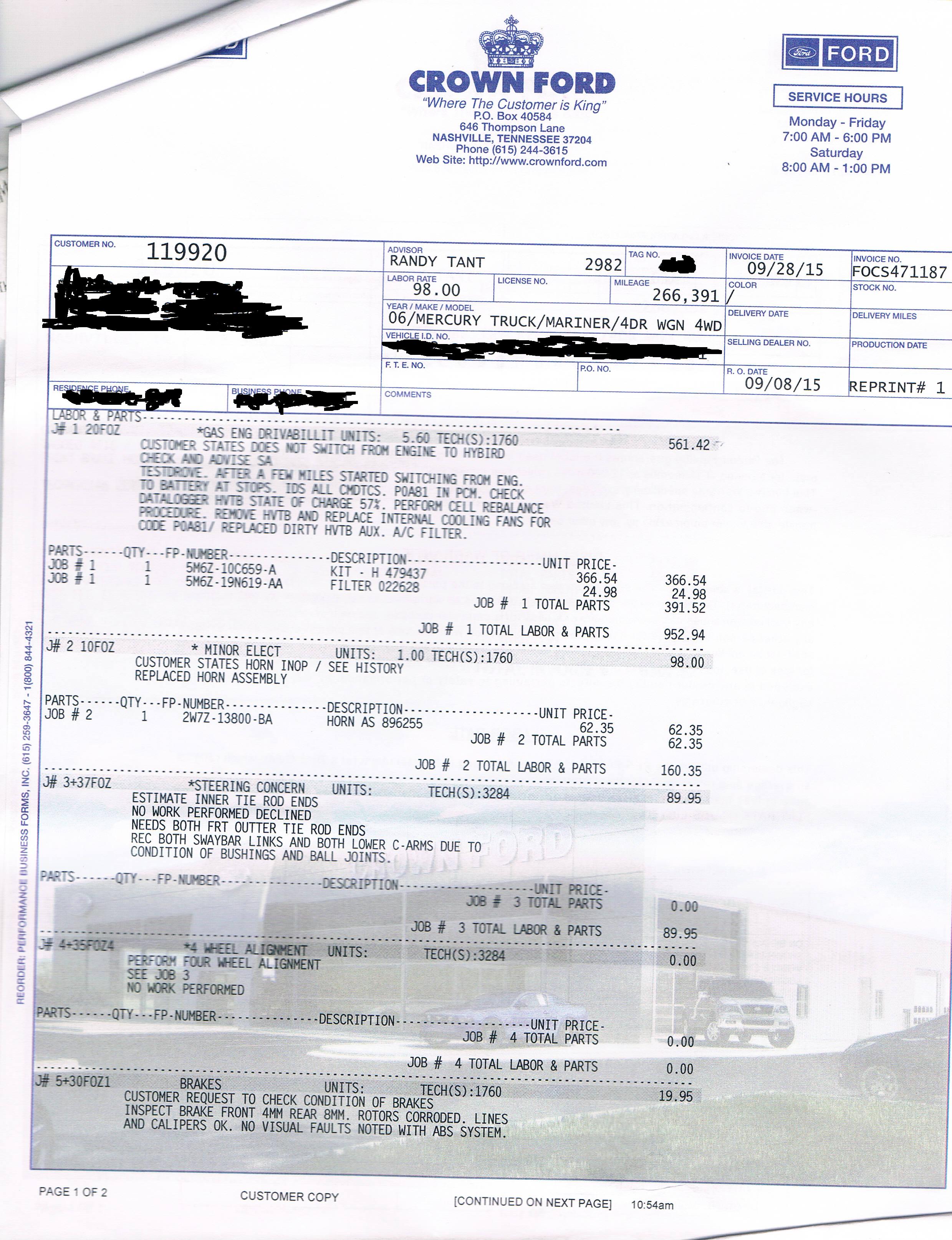

Could you give me any information on why the battery was rebalanced and what exactly he did to it? I am having low assist on mine and the temps of the battery are in the high 60s to mid 70s so I don't think it is heat related at all.
Thanks,
Tyler
Old Nov 16, 2016 | 04:53 PM
Slate's Avatar
Joined: Sep 2016
Posts: 43
From: Tennessee
Default Re: My new 06 MMH with 282k miles
Here is a copy of the invoice with some info. I dont know if it will help any.
Old Nov 16, 2016 | 05:51 PM
08escapehybrid's Avatar
Joined: Jul 2016
Posts: 173
Lol, looks like the dealer just scammed them. A rebalance is a long drawn out procedure that definitely doesn't cost a few hundred. The issue looks like it was the fans and the dealer padded the order by saying they did a rebalance. A proper rebalance requires an insane machine to do or about 25 days diy. The cheapest I have seen is like 1300 for a rebalance on the escape.
