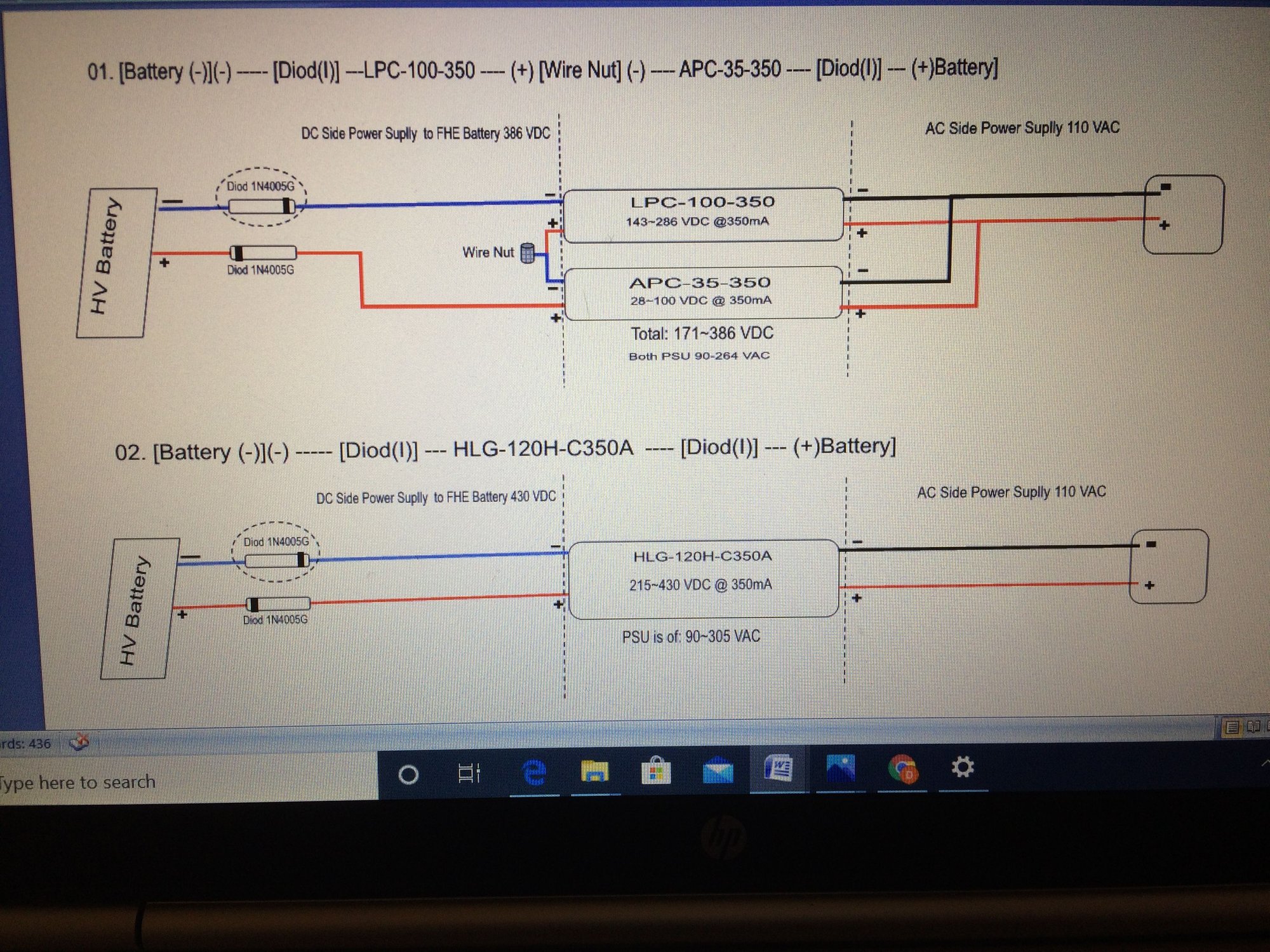

Have done some Live test , DTCs in Modules, Service Procedures and the Scan report are shown in the picture in this post for your kind attention and valuable opinion.
04. I am guessing all these DTCs are somehow interrelated and due to the HV battery is at low voltage, if this is correct, charging the battery and attempt to start it will be the first
initiative. I have drawn kind of a diagram keeping in mind your suggestions which is shown in the pic.
05. Are the connections made in the diagram correct?
06. Which charger will be BETTER LPC-100-350+ APC-35-350 or HLG-120H-C350A ? If HLG-120H-C350A is used should it be set at max output? (for voltage 110vac)
07. What kind and what voltage of Fuse ( example:.Fuses with Leads (Through Hole) FUSE, CERAMIC TUBE 1.6A, 600VAC/600VDC 0ADAP1600-RE Datasheet ) should be
appropriate one and which lead should have it ?
08. I was thinking to use cable/wire of (DC output) 16/18 or 22 AWG since HLG-120H-C350A is of 17 AWG wire and LPC-100-3500 is of 18 AWG wire, but you mentioned 28AWG to get low current flow (this sounds GOOD ) your opinion on this once again ?
09. After Charging and before I attempt to start the FEH, should I clear all codes? If I have to, will I be able to clear these codes by FORScan? or it will reset once the battery is
disconnected?
Thanks for taking the pain to read the post and it will be highly appreciated if you could reply on the above for a person stuck in middle of a desert without water.....luckily has internet and laptop! Thanks....once...again..

Originally Posted by unicorn
Dear S.Keith,
your thread contains highly appreciable information, ‘Thanks’ from the bottom of my heart, read your post related to 2008-2009 FEH, your patience, prompt reply, practical solution and inspiring advise is life saving, therefore will try to bring back life in to my Ford Escape Hybrid 2009 (87k mileage), which has been laying in back yard for nearly a year and the HV battery is at 241V now.
01. I bought a new 12V battery 6 months back and tried to start the FEH but it didn’t work then. Now used Schumacher BE01255 Jump starter 245A@5ec., PEAK 1200A,+ charged the battery to 12.9V, but as soon as I connect it with the FEH and turned the key the voltage drops quickly. Should I return the 12V battery and get a new one?
02. Dashboard shows Wrench, Check Engine, Oil and Red Triangle sign.
03. I have scanned the FEH with FORScan using ELM327 and the scan report for DTCs are
DTCs in PCM : P1000:00-2B, P1A10:00-2B
DTCs in ABS : C1014:07-60, C0034:29-60, C0031:29-60, C0021:21-60, C1018:00-20, U3003:16-60
DTCs in TCM : P1260-FF
DTCs in BCM : P0A7D-60
DTCs in IC : B1318-20, U2023-20, B1601-20
disconnected?
01 12V must be healthy and charged. Any ignition on voltage of 11.5V or greater should be fine; however, that is the low limit on a marginal battery.
02 Expected due to codes present
03 thanks
04 Most likely. HV battery voltage must be resolved before meaningful diagnostics can be continued.
05 both are correct.
06 no difference. Cost and availability.
07 1A/250VAC on supply side.
08 you're only passing 0.35A. 16/18/22 awg are all way more than sufficient. 28 can pass 0.83@60°C, and you should get nowhere near there. https://en.wikipedia.org/wiki/American_wire_gauge
09 clear via 12V disconnect for 5 minutes
Charge for 4 hours prior to attempting start. 4 hours of charging will only put 1.4Ah vs. 5.5 rated into the battery.
Once started, do not drive, and allow the car to idle until 1) until the ICE shuts off or 2) 20 minutes. This ensures the ICE has charged the HV battery to within the normal operating range.
