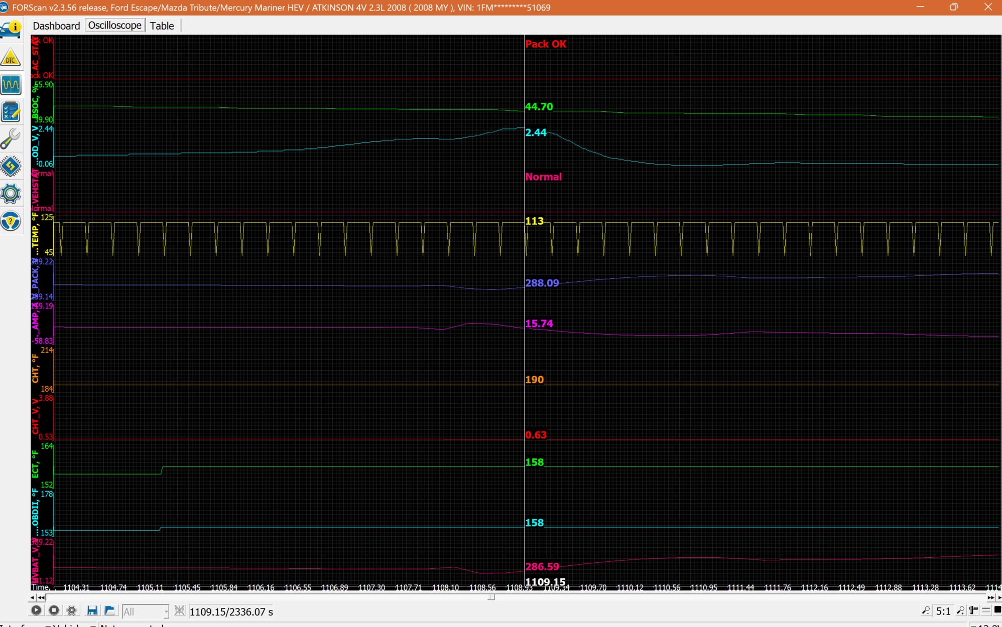

During acceleration a few times today I saw this. Never saw anything like this before when driving. Still intermittently low BSOC in the morning when I start, but usually comes up pretty quick without having to do a jump.

If that's showing DEL_MOD_V of 2.44, that battery is toast. You should have no expectation of reliability.
