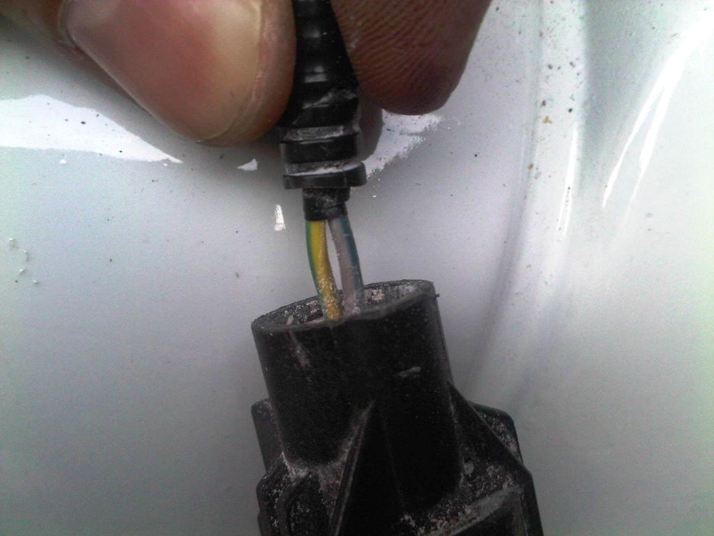

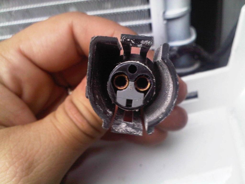

Here you have 2 pics of the connector and the wires...Yellow-Green/Gray-blue

I've checked the temperature on the display (top of CD player) and it shows 50F when it actually was -let's say- 81F...so that could be for the outside temp. sensor...
This post confirms that: http://www.escape-city.com/viewtopic.php?f=13&t=1931
Case closed for me.
