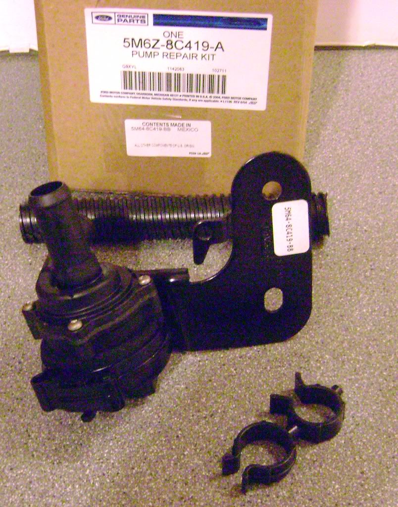

Since I'm fighting this same battle, I went to a new dealer today and talked to the tech who says he's the only qualified hybrid tech in my area. Very upfront guys.
He said in his experience the famous P0A81 code is typically related to a water pump (still a cooling issue), and not really a fan issue at all. He's replaced several of them and never had anyone come back with more issues. Of course, the water pump isn't covered.
So, he's 99.9% sure the water pump will fix it. And if it doesn't, they will fight with Ford to get the whole battery replaced. We're going into Arizona summer, so if the fans are truly bad the issue should resurface soon enough. No shortage of heat here.
Anyone familiar with a water pump issue? Thoughts on this?

This is a photo of the electronic water pump that you are referring to:
It is a known issue. Around $165.00 from BlueSpringsFord.com

If replacing the water pump does not fix your problem, then I would say that you are owed cooling fans PLUS a refund for a water pump that was needlessly installed. Hope it works out for you.
