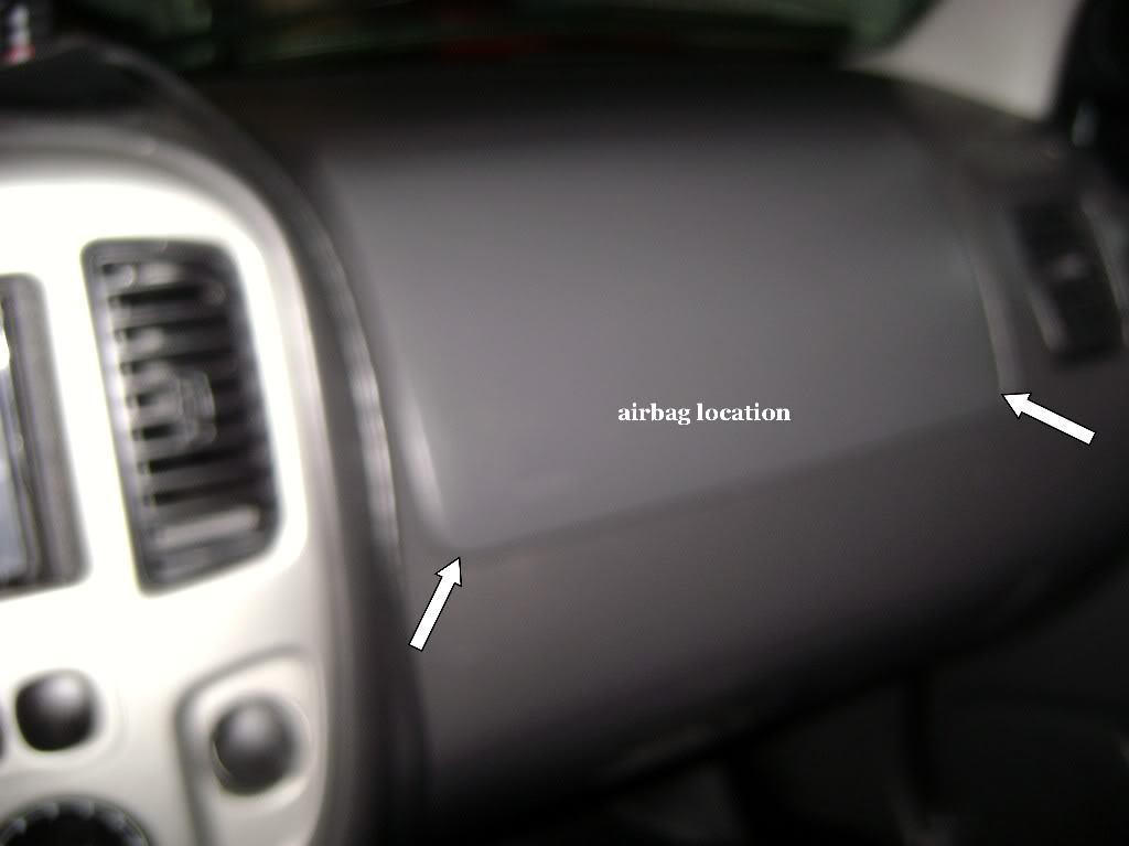

Another thousand word photo, as the airbag ejects from a specific area on the 2005 Hybrid.
That is great - the 2007 and below owners need not worry...
