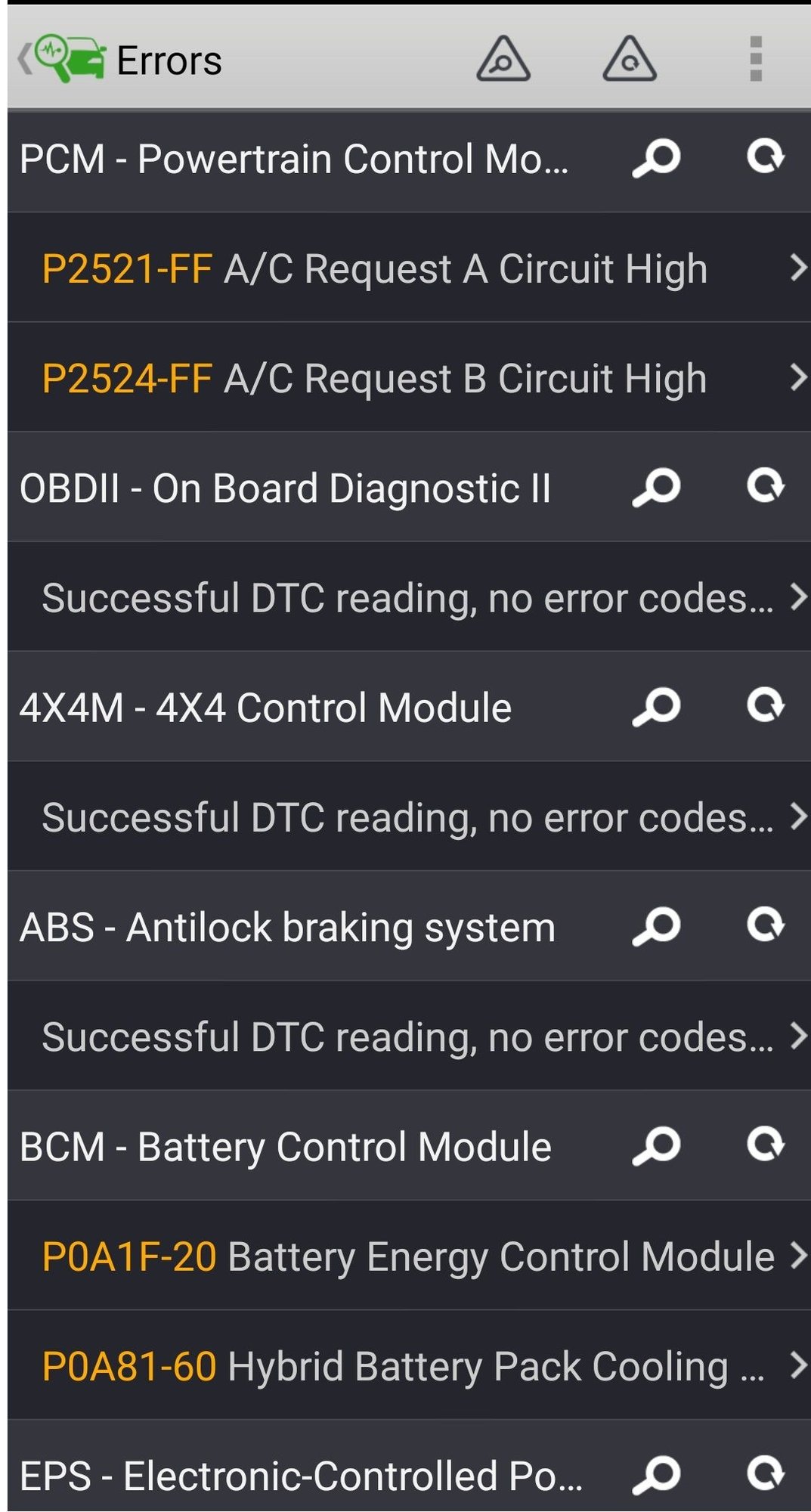

I have BCM codes P0A81 and POA1F and PCM codes P2521 and P2524 (screenshot attached)

P Codes found

When this happened to me it was due to a broken A/C refrigerant line. Due to the first two codes, it is likely the same issue. I would also run the BCM self-test (which checks the fans) and check the battery compartment air filter as it could also be an issue with one of those.

I cleared the codes and the two AC codes have never returned. My AC blows cold so I am not sure what set those codes in the first place.

My car is running much better and more predictably, the only thing now is that POA1F still come back after clearing codes.My guess is that I have a few bad cells and that might be triggering POA1F (ForScan data suggests that I have at least one cell that will not charge above 55% SOC and that this low cell drops quite a bit while sitting. Rebalancing allow doesn't charge this ler ow cell)
I would be interesting in hearing any other thoughts on POA1F now that I have solved the other codes.
