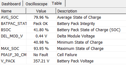

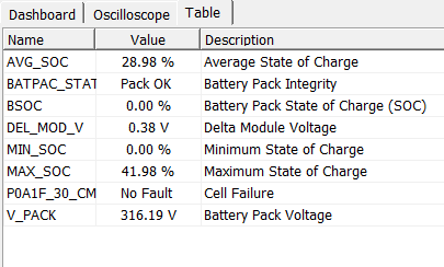

Battery stuff:
12v battery freshly charged, just performed the jump start
After running back and forth on my driveway
I would have pulled figures after my short drive, but the battery in my laptop ran down.
Thoughts? Comments?

High revs were due to low HV Battery SoC.
.31V is high on the DEL_MOD_V.
I recommend you start and let it idle until the engine shuts off. Should charge to around 40%.
Key off
Key on/engine off
Open RMODE_BALANCE function
Key to start
Wait until engine runs
Start RMODE_BALANCE and wait until it finishes
Key off
Key on/engine off
Key to start
Done.
After rebalance
