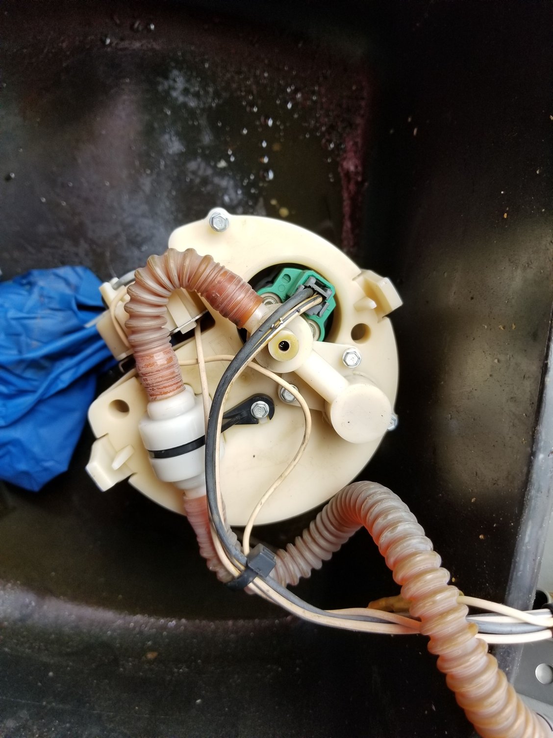

My 05 pump motor went out AND the hose that's part of the assembly split in the tank. Double whammy.
New pump assy from Rockauto, and she fired right up.

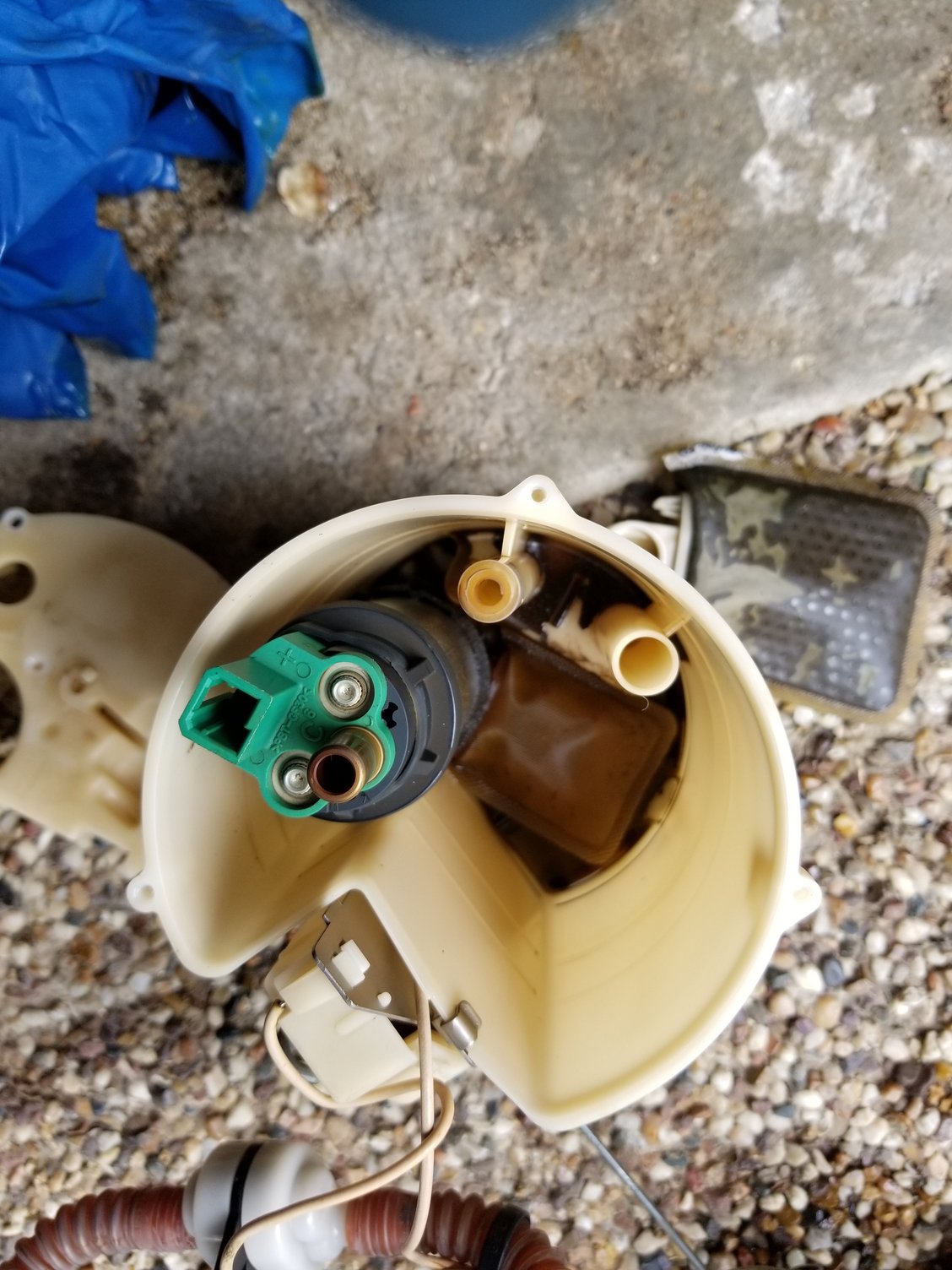

Oh well, another Tuesday, and I'm working on the Hybrid again. Yes, it's weird that I only end up doing this on Tuesday afternoons, but my schedule is kinda wonky lately.
Got the old pump out and tore it apart, pretty easy to disassemble, just need a REALLY small nut driver - 3/16".
Pretty gunky inside, the pickup filter was uglier than it looks
Standard size and length for Ford pumps
The pumps I had lying around for my F150 were the correct size, with the same fitting placement, but the electrical connector was slightly different. Some of the bare pumps you can buy come with their own pigtails, so this normally won't be a problem. Note the part number on the pump: 6C34-9350-AA.
This is a VERY common Ford pump, you can get it in a lot of places new for $20-30. For example, if you have an early Escape or Ford Focus 2001-2008, of any engine size/type, this is the pump you need.
I just pirated a know good pump out of a 2002 V6 Escape, and it works!
