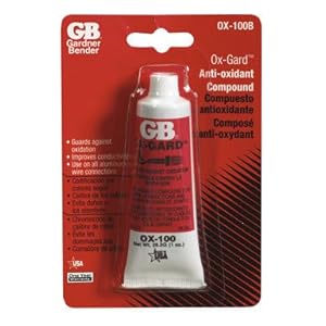

Originally Posted by EVDRVR2
I use GB OX/Guard on the connection to the charge port on My EV.
Does this look like the right stuff?

True, shmoo, if you put dielectric grease on conductive surfaces it will insulate them from each other. That's what dielectrics do. This kind of grease is not to be used on conductive surfaces, period.
There's a difference between dielectric grease and anti-oxidant compounds. Anti-oxidants prevent the formation of an oxidation layer that in most cases is non-conductive. It is designed to be conductive itself.
Don't confuse people with partial info.
No, that's not dielectric grease which is to be used on electrical connectors. Look for something like the CRC brand that I mentioned above. I've used the CRC dielectric on injector connectors on a Ford product because they all had some form of grease on them right from the factory and never had a problem with them.
