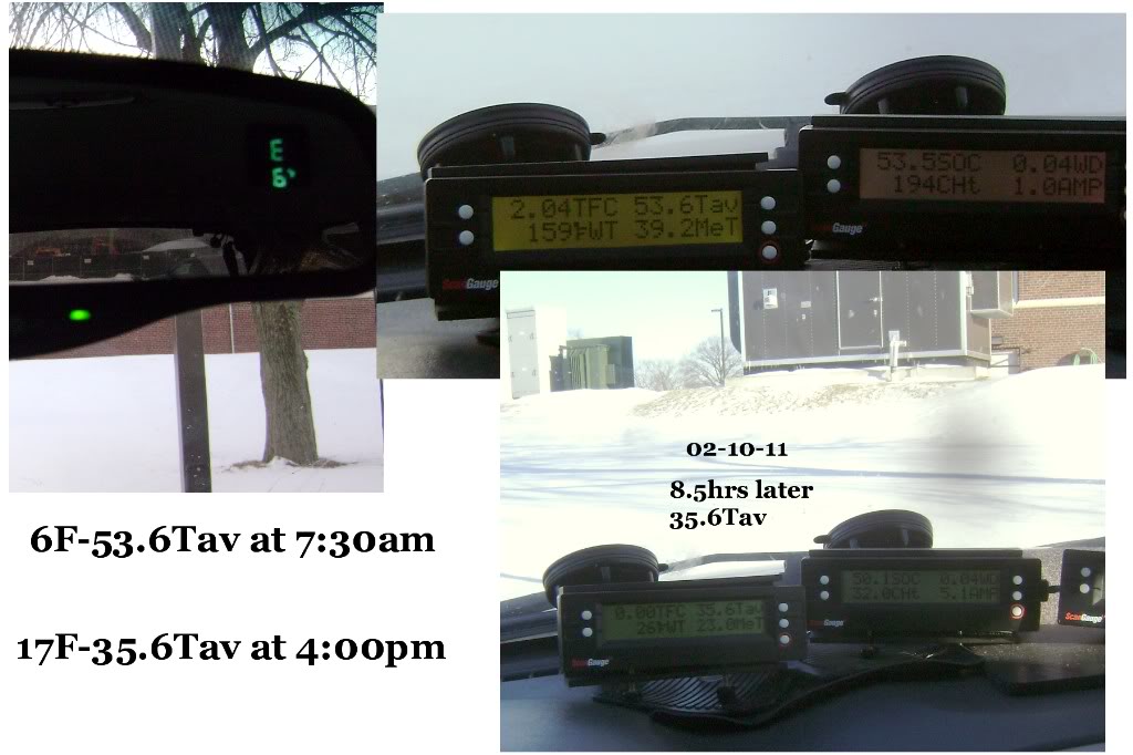

The cylinder head temperature (CHt) can be a programmed and displayed value as shown in the photo:
That's good to know. I could probably find this if I wasn't so lazy... But is there a complete list of gauges that can be programmed for the FEH? Can you point me to that? Do you really have 3 gauges hooked up to your car all the time or is the picture just displaying a test of some kind you're doing?
