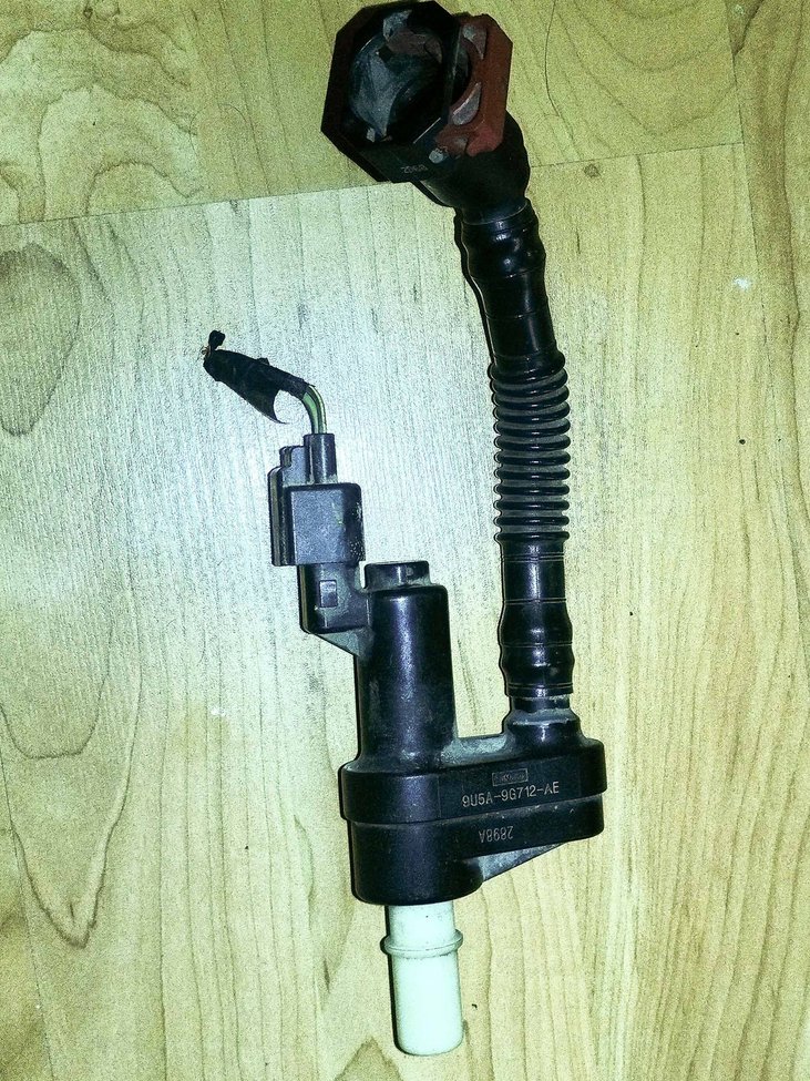

You're definitely getting ripped off.
https://cimg5.ibsrv.net/gimg/www.gre...24b12d5545.jpg
https://cimg6.ibsrv.net/gimg/www.gre...dc92290051.jpg
You can try to clean it or go to the junkyard. I had no driveability issues for this code but it does need to be fixed to pass emissions. Even a new one on ebay is probably less.
