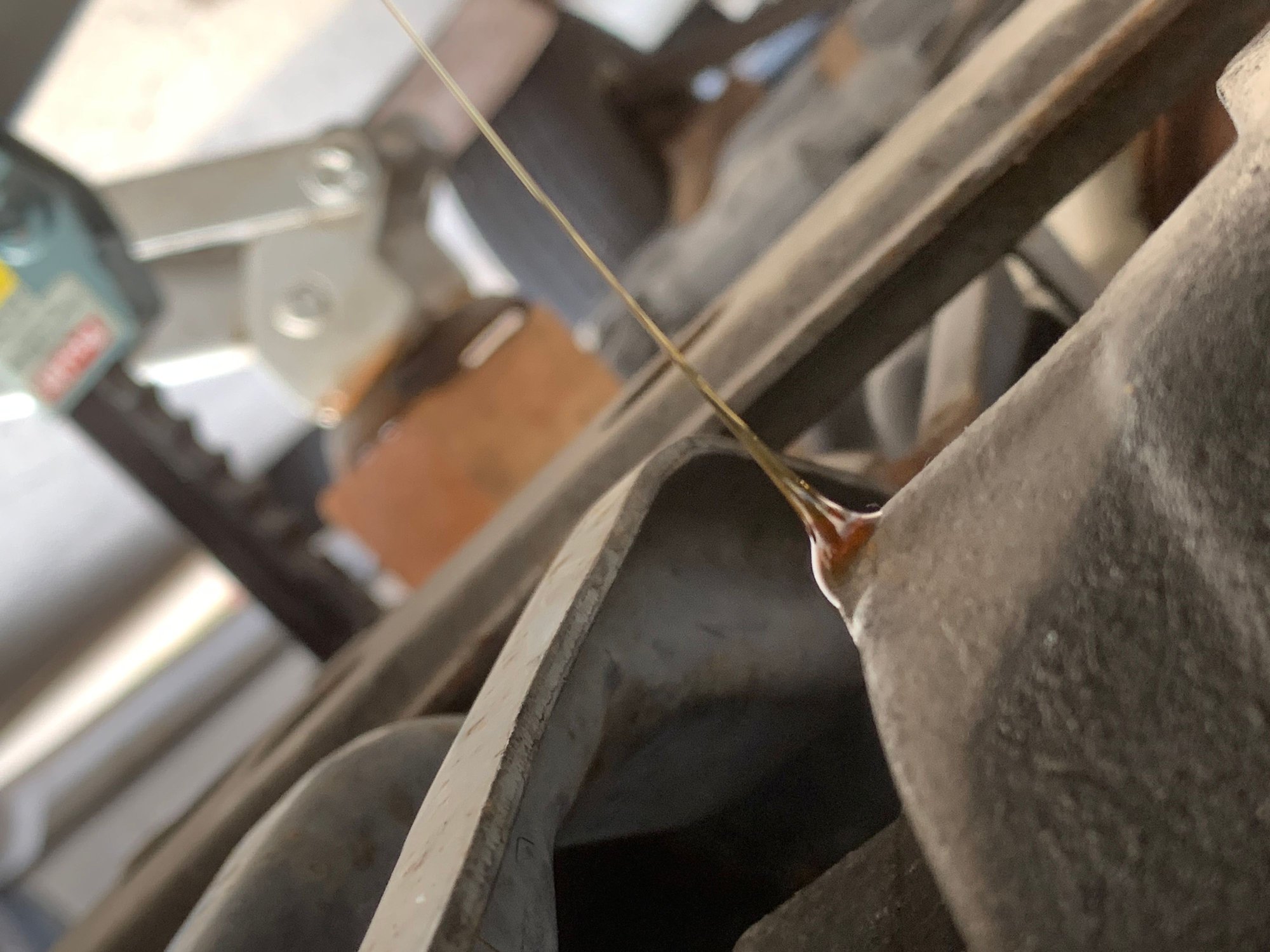

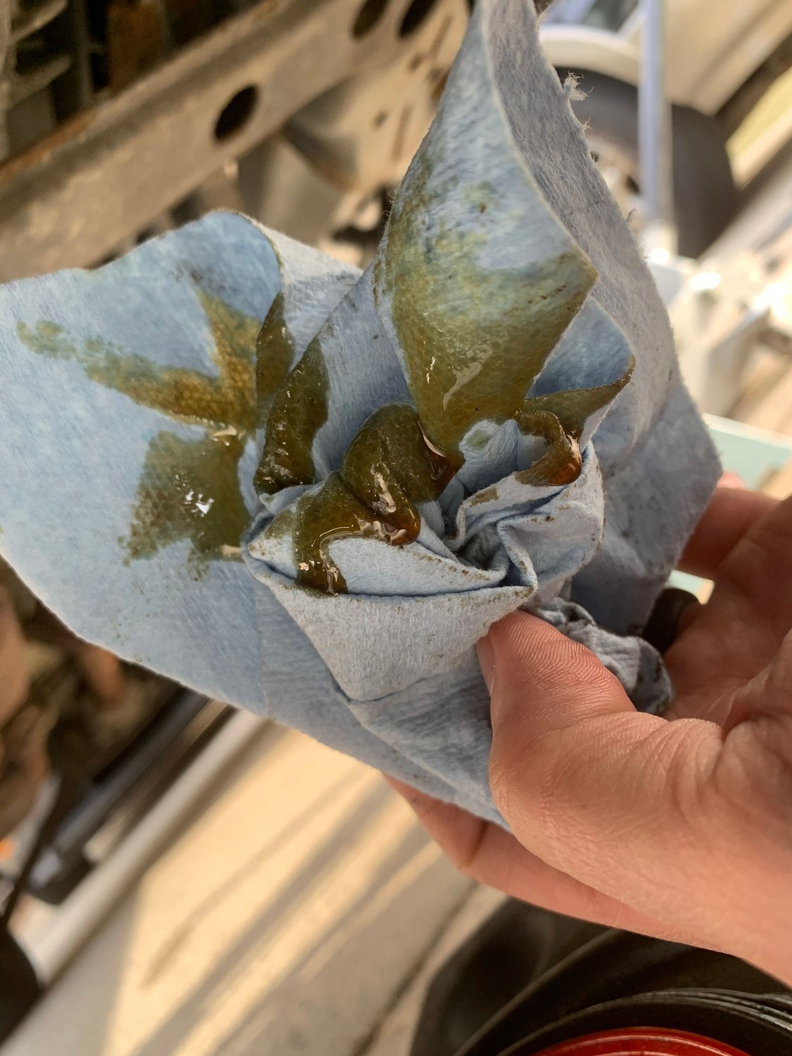

Well I changed the PTU fluid this morning. What came out actually looked pretty good. Not brand new but had life left. Makes me feel more comfortable about how this car was taken care of!

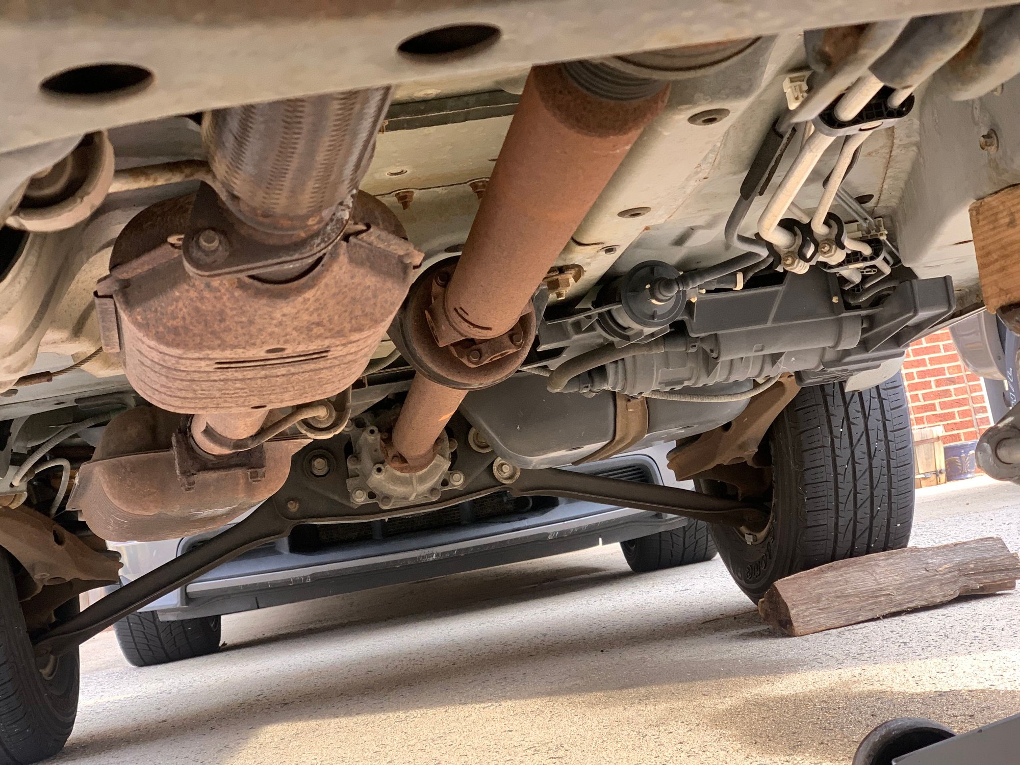

That's beautiful, I'm very happy for you and glad to see it. Better than any 16 year old car has the right to.
This is how ugly they can get:
You might take a close look at that boot/spline toward the front of the driveshaft, but otherwise that undercarriage looks great at least to my eyes. New Mexico.

Thanks for your feedback. The yard would definitely be cheap; $21/fan. At that price, should I decide to to that way, I may just pull all 4 of them there. While I am an engineer by profession and consider myself a decent back yard mechanic, electricity and electronics is by far one of my weakest subjects. I would probably at least attempt to diagnose them at least. I may go pull the fans tomorrow. Still debating, but will report back.
Side note, changed the trans fluid too. Very easy job. Old fluid was definitely darker.
