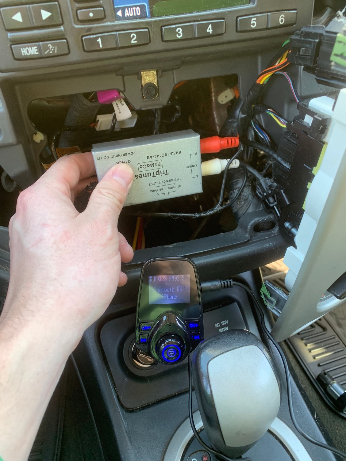

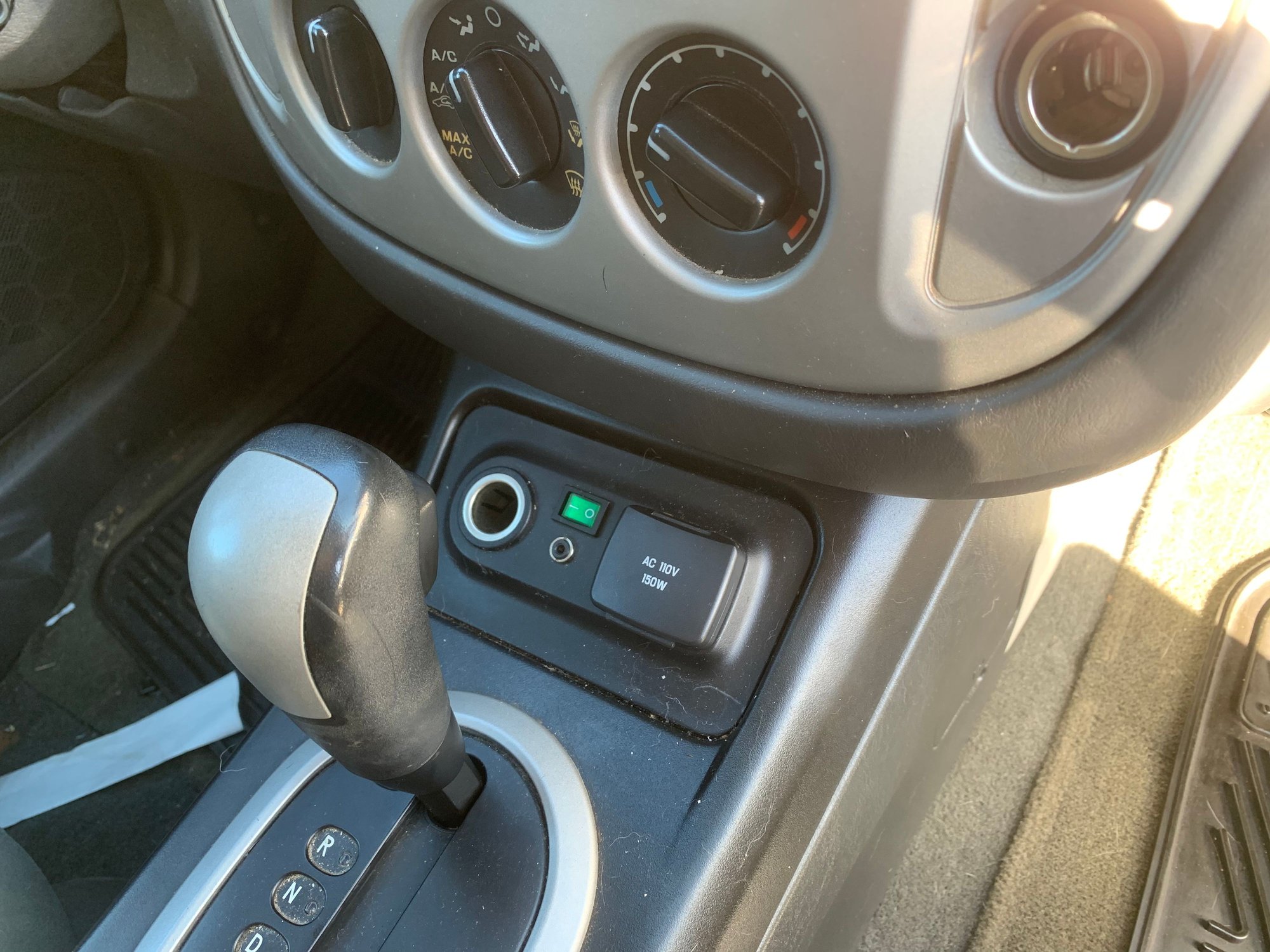

Hi all,
New member here. My wife and I just picked up a really clean 2006 Hybrid with 121k on it for a price that was too good to be true ($200) and to hopefully tide use until our make believe Bronco hopefully gets built at some point. It runs great so far, but has one feature that’s driving me nuts. Between the power outlets by the shifer there’s an Aux In port and I can’t figure out how to use it to save my life. I’m assuming somebody added this at some point. Would anybody have any ideas how this would be usable? It’s got the factory nav head unit with a CD changer. I’m almost to the point of wanting to take panels off and trace the wires. Thanks for any help!

Mystery solved. Found this buried in the dash. The real kicker is that it sounds worse than the Chinese FM transmitter I was using. Oh well!

Surprisingly it's a factory accessory. Found it in the 2006 escape accessory catalogue, haha.

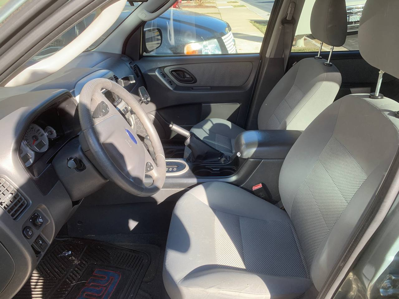

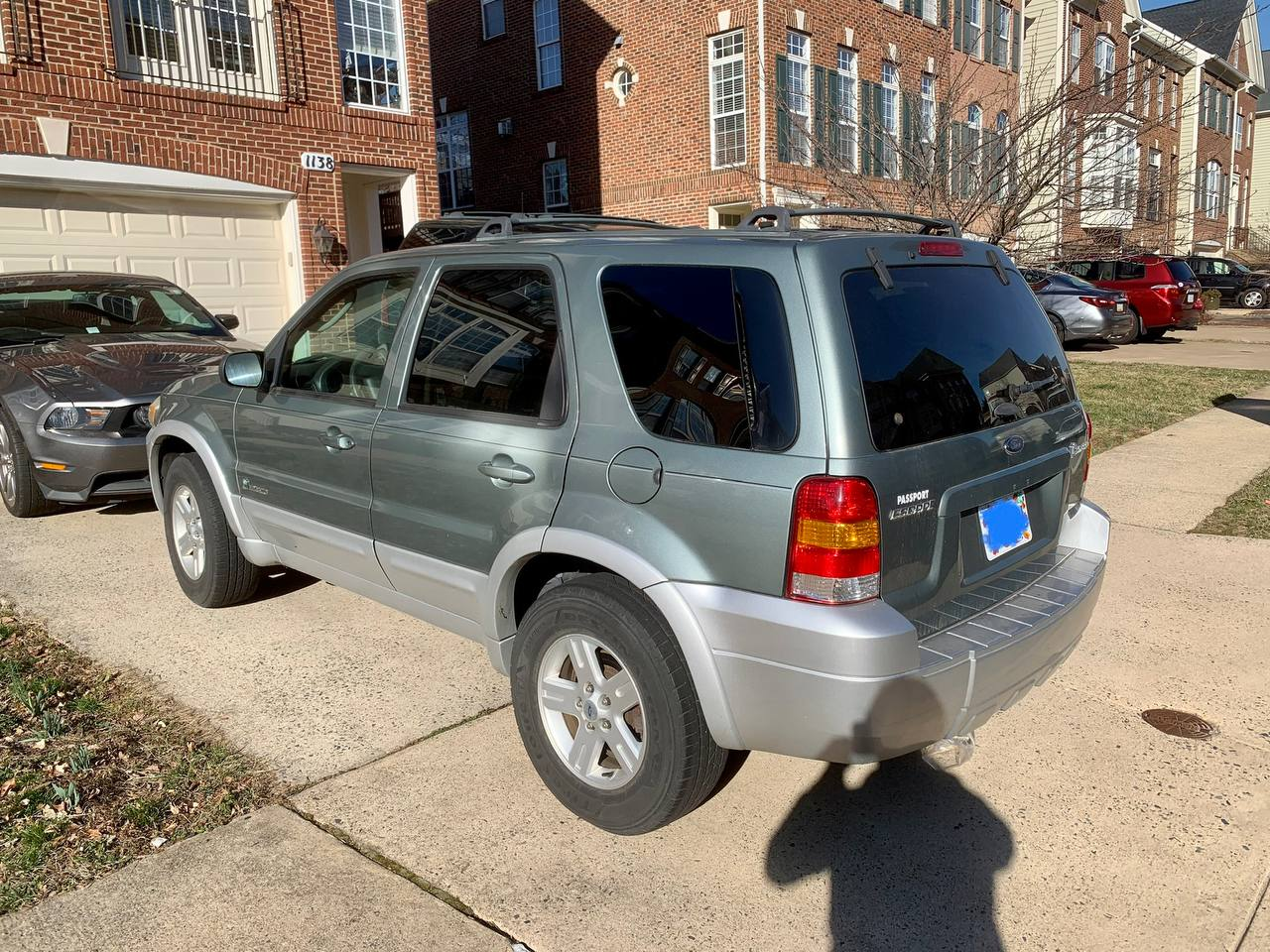

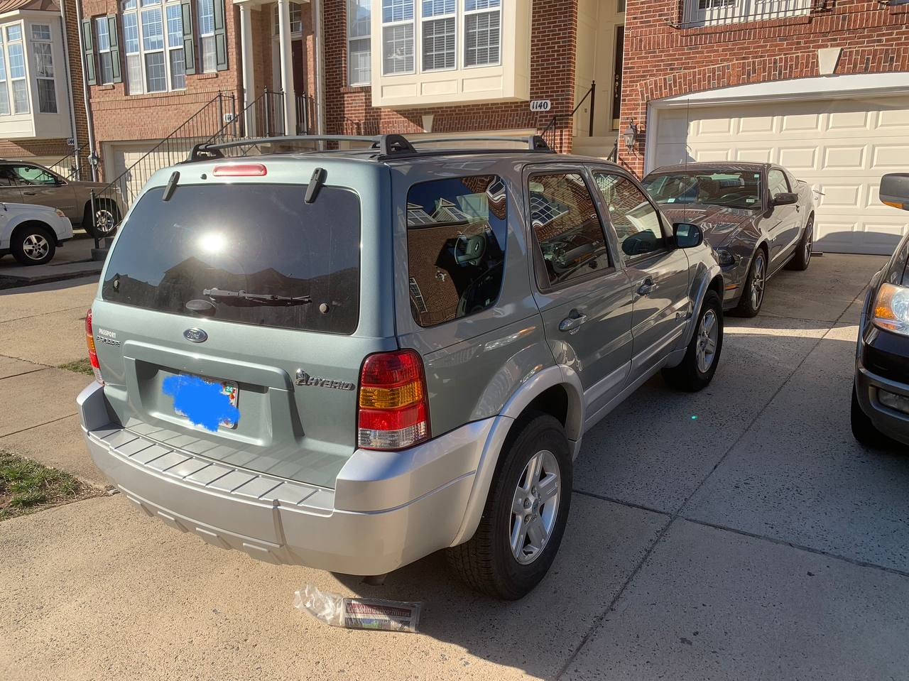

Thanks for all tips. It definitely is a clean car (see more pics below). Not a hint of rust on it. It lived a lot of its life in New Mexico, which I'm sure helps. I ordered some Mercon V and 75W140 from Bezos to do the trans and transfer case; hopefully will get that done on Sunday. May do the diffs while I'm at it. Regarding the end links, I do think they're on their way out as they're definitely pretty clicky. I helped my father-in-law replace them on his '09 FEH and it was a breeze (and I have replaced them on several other vehicles as well); you can actually see that car in the background of the pics below.
A/C works fine as well; time will tell about the battery. Honestly, for the price we got the car if I had to fork out for a new (or reman'd) HV battery, I wouldn't be too upset. Luckily it appears to be working just fine.

Very nice. Nice wheels, really nice cloth interior (the leather with the soy based cushions on my 2010 Limited is suffering from a little side-bolster cushion collapse on the driver's side, not too bad but still...and I actually prefer the cloth interior in hot AND cold weather, yours looks great!) nice mileage, very nice two-tone body treatment. Emergency brake where God intended it to be.
That's a very cool car that still looks great, the 3M kit will polish out those headlight lenses to like-new. It looks like you've got zilch for body rust. Get under there and make sure there's nothing else that needs attention. Yours has the NAV too, which even though it is smaller is still "cool" in my book. Good stuff, and man - the price was RIGHT!
Best wishes with it, this is why I wish they kept making the model a few more years. They still really look good and the basic platform is solid.
