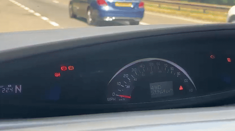

Hello, I have a 2010 Toyota Estima Hybrid E-Four X. The car runs perfectly fine when I'm driving around the city. But as soon as I go on the motorway and drive above 50–60 mph, it starts showing fault codes and stops accelerating. I have to pull over, turn the car off, and restart it. When it starts again, the fault codes are still there. After driving for a bit at around 30–40 mph, the same issue happens again. Eventually, the car won’t start at all unless I disconnect and reconnect the battery.

Thanks for getting back to me. I’ve been to over 10 mechanics and they all said the DC converter needed replacing, so I got it changed today for £600. I drove less than 20 miles and the same problems came back. The warning lights showed up again saying "Check Hybrid System," "VSC System Check," and "4WD System Check."
