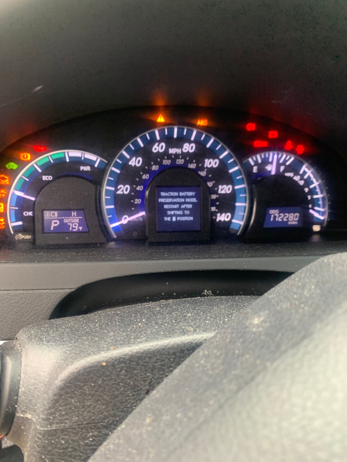

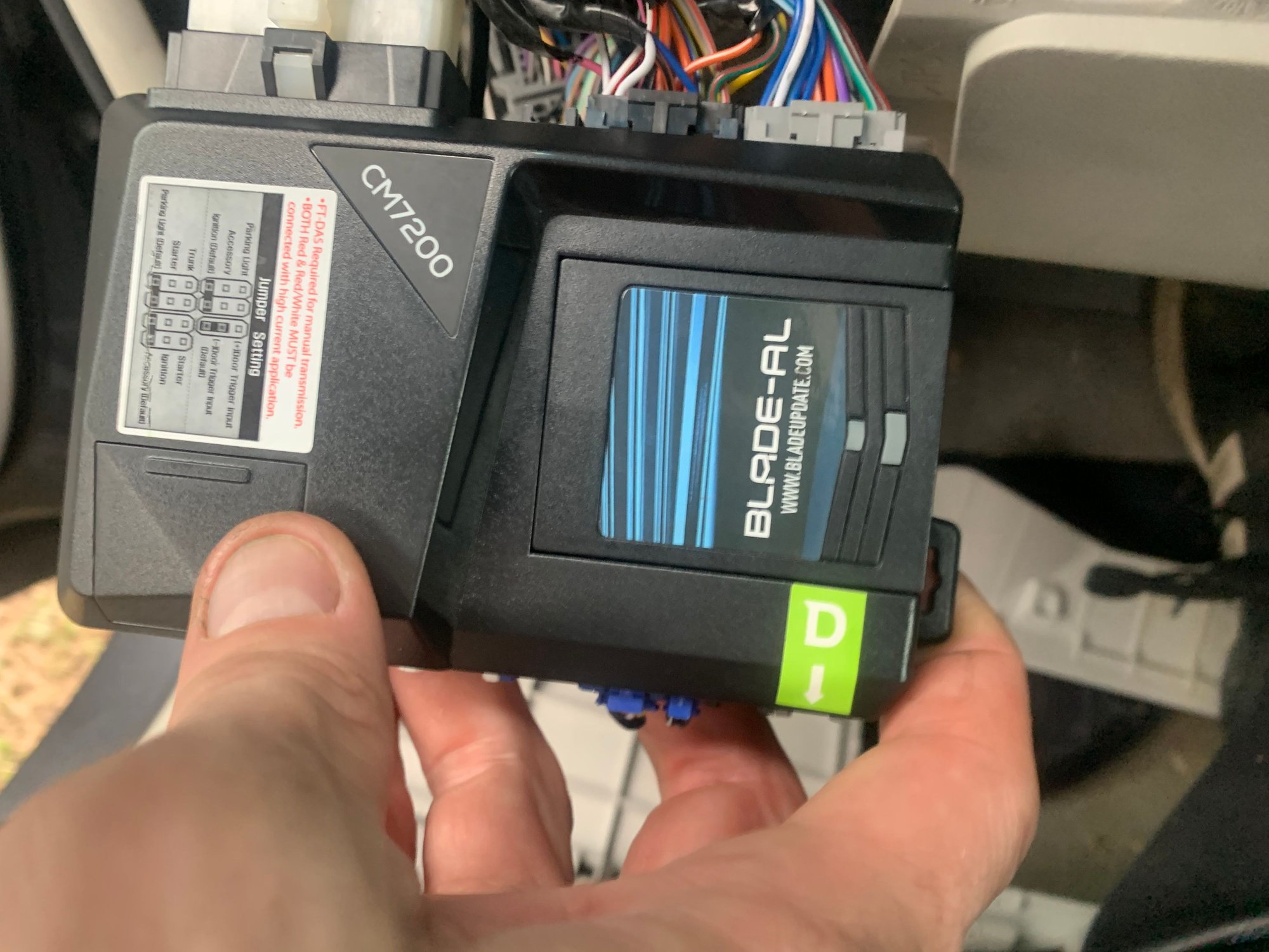

Found this module zip tied up under the dash for remote starting system
No Ready Light
No Ready Light

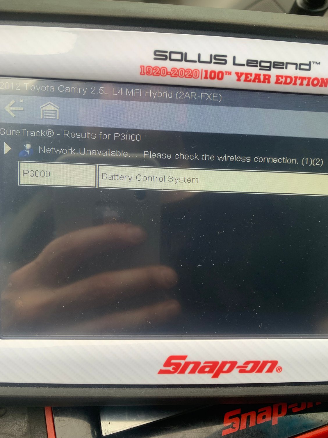

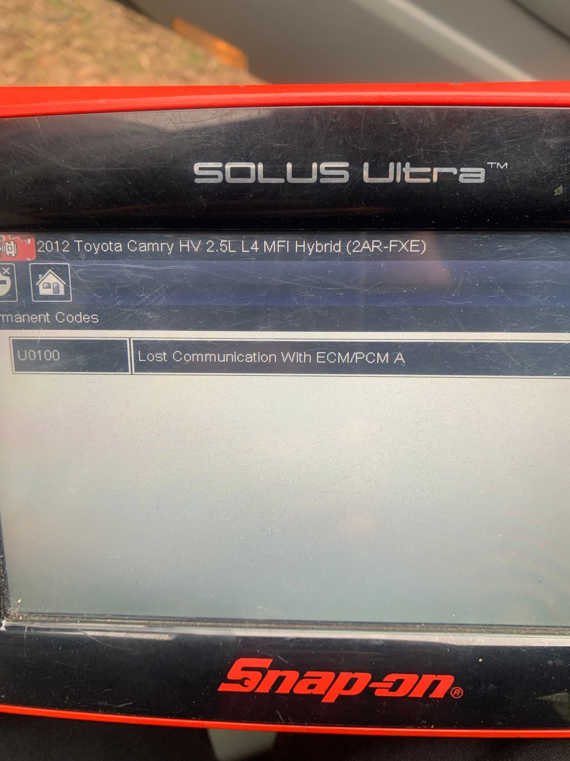

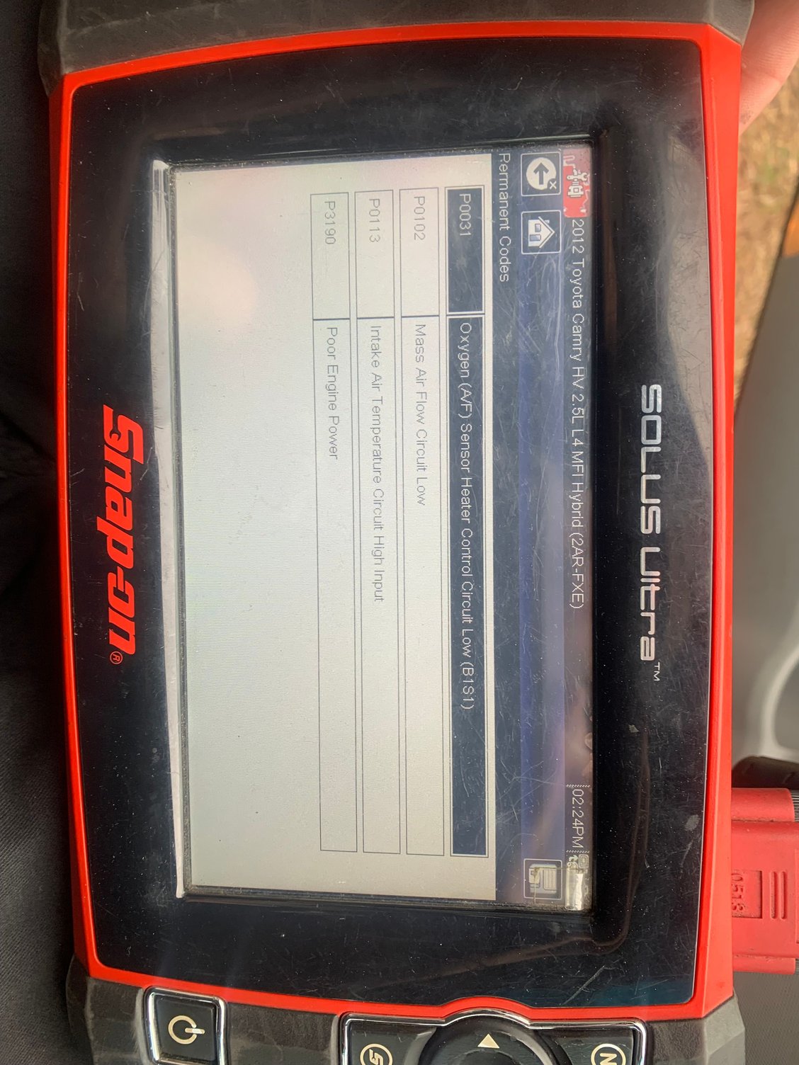

Old Apr 3, 2025 | 10:56 PM
Default Re: 2012 Toyota Camry Hybrid - No crank
P0102 and P0113 indicate likely MAF sensor failure.
P3190 is thrown frequently when the engine fails to start like when you have a faulty MAF sensor or dirty throttle body.
P3000 is a generic hybrid system fault. It doesn't mean anything by itself.
