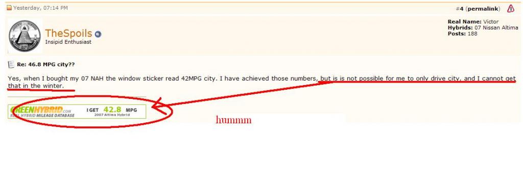

Originally Posted by TheSpoils
Yes, when I bought my 07 NAH the window sticker read 42MPG city. I have achieved those numbers, but is is not possible for me to only drive city, and I cannot get that in the winter.
Why is your Real Time average showing 42.8 then?
Old Jul 20, 2009 | 05:25 PM
TheSpoils's Avatar
Insipid Enthusiast
Joined: Sep 2007
Posts: 205
Default Re: 46.8 MPG city??
Yes, the window sticker rated 42 city and I am at 42.8. I have achieved 46 on a few tanks and 39 on some highway tanks. Sounds about right, No?
