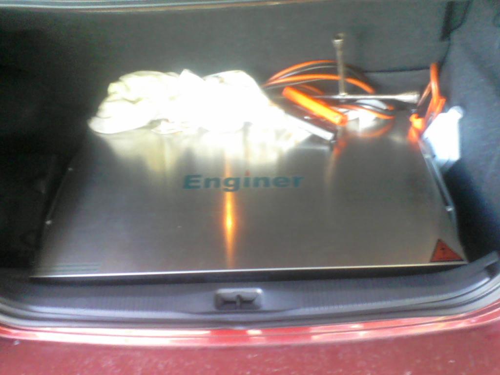

Tight fit of the kit in the trunk.

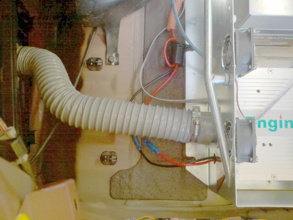

View of the heat exhaust tube going to air vent in trunk floorboard and power wires to the hybrid pack.

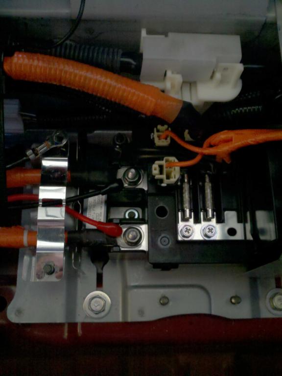

Tear down pictures, showing original pack, high voltage cover, high voltage tie-in and bumper hole.

Vent hose to trunk vent.

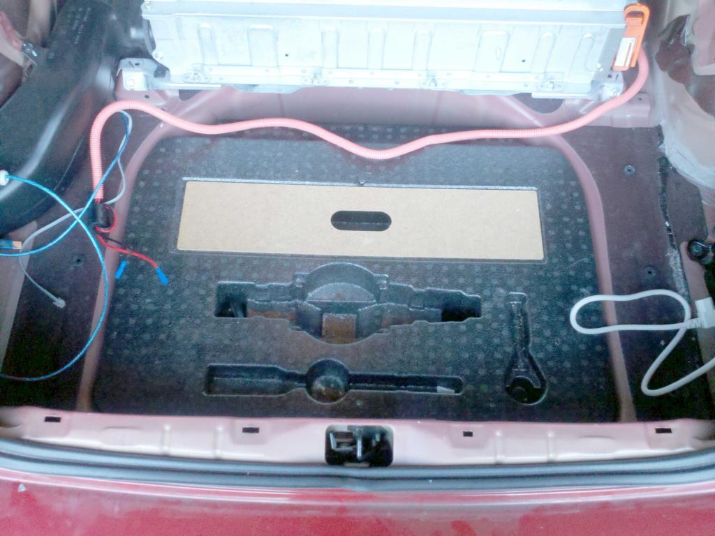

Enginer mounting holes in trunk floor board.

Trunk back together.
