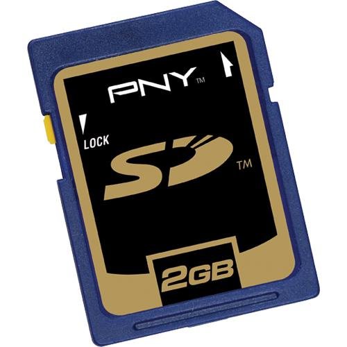

I'm not a memory card expert, but if it works for you, then enjoy the music! I love my 2 Gig PNY SD card and I didn't do anything special--I just loaded it up with songs!
Corrected above from SanDisk to PNY. Click for picture.
