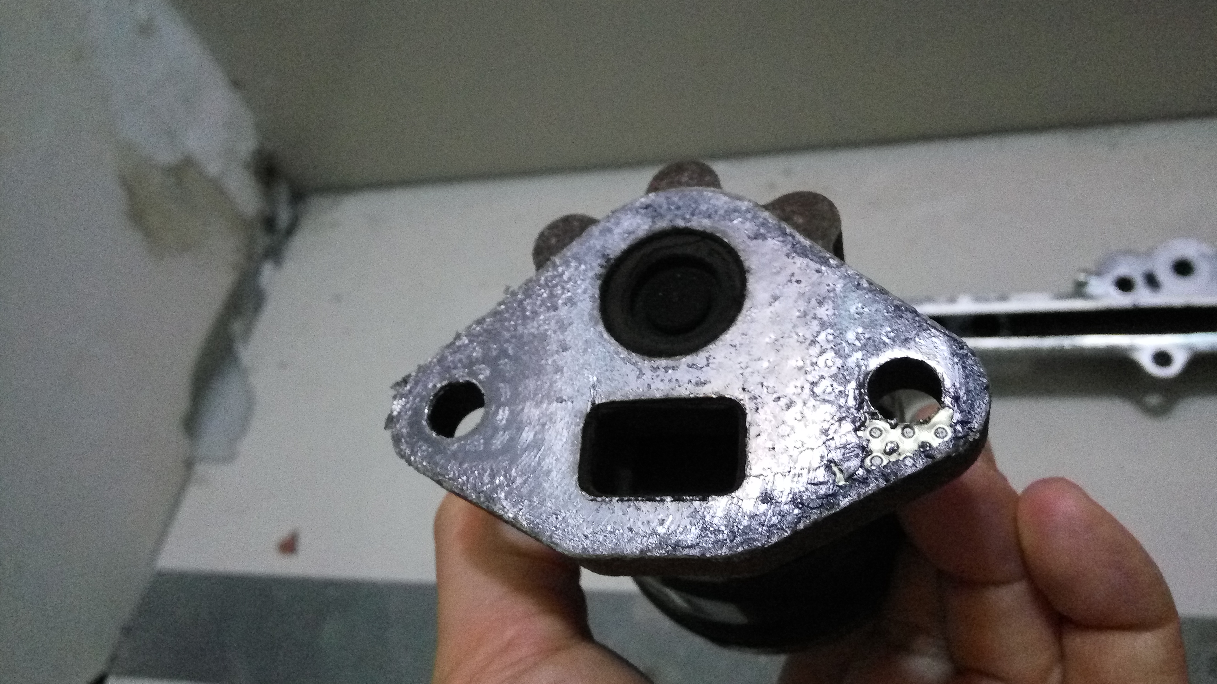

I did it. Simple removed tons of **** from EGR port. That was really easy.
Another question: how this valve works? If I remove the valve, I see two hoses there. One is square window, another is round. Is this round valve itself? Does it move inside if I push to it? Mine not, it stuck. Is it normal?
Old May 11, 2016 | 01:13 PM
Posts: 5,222
Default Re: Knocking (detonation), HCH II, 2009
I can't say for sure. I fiddled with it many months ago, and I don't recall being able to move it.

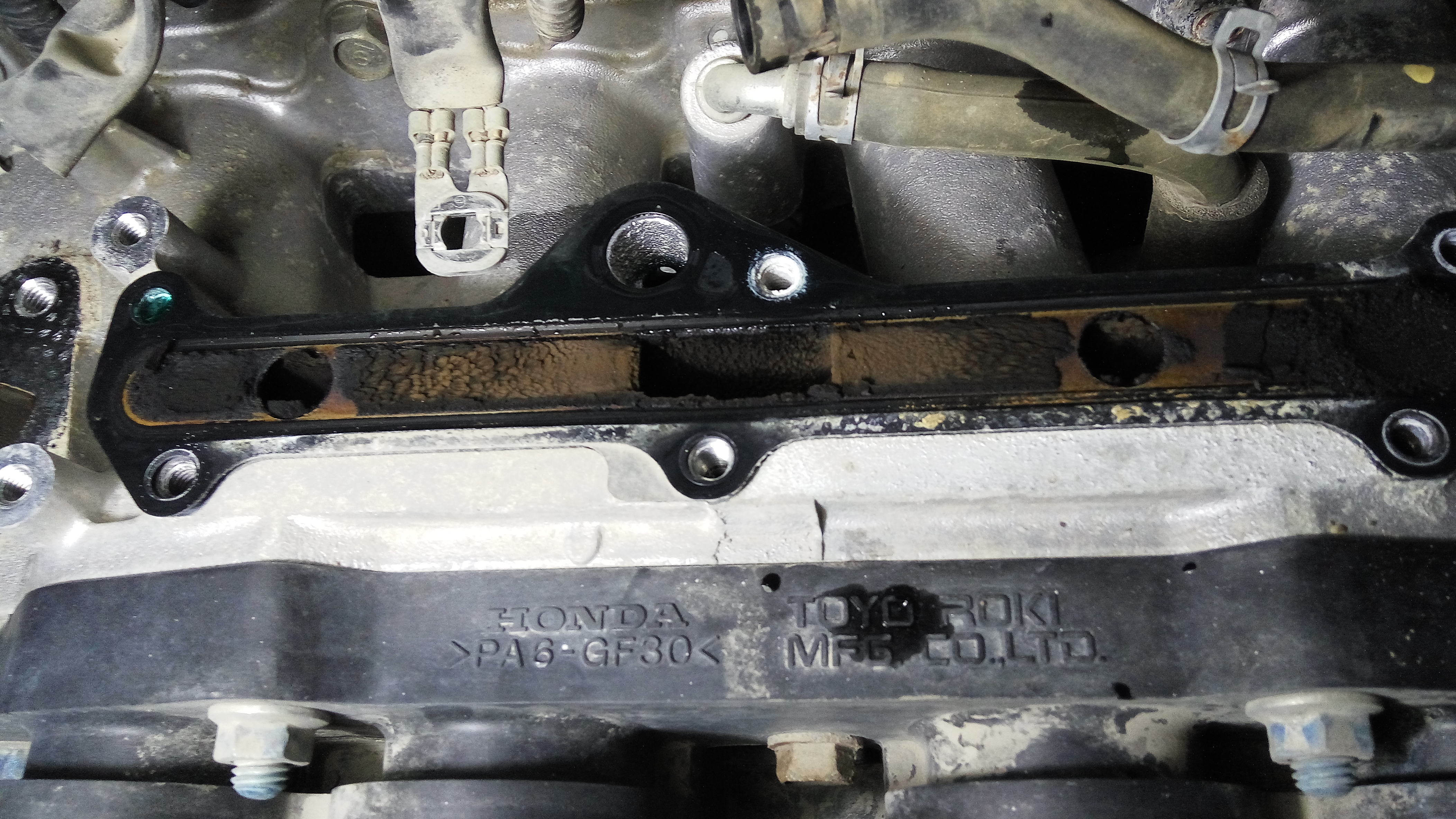

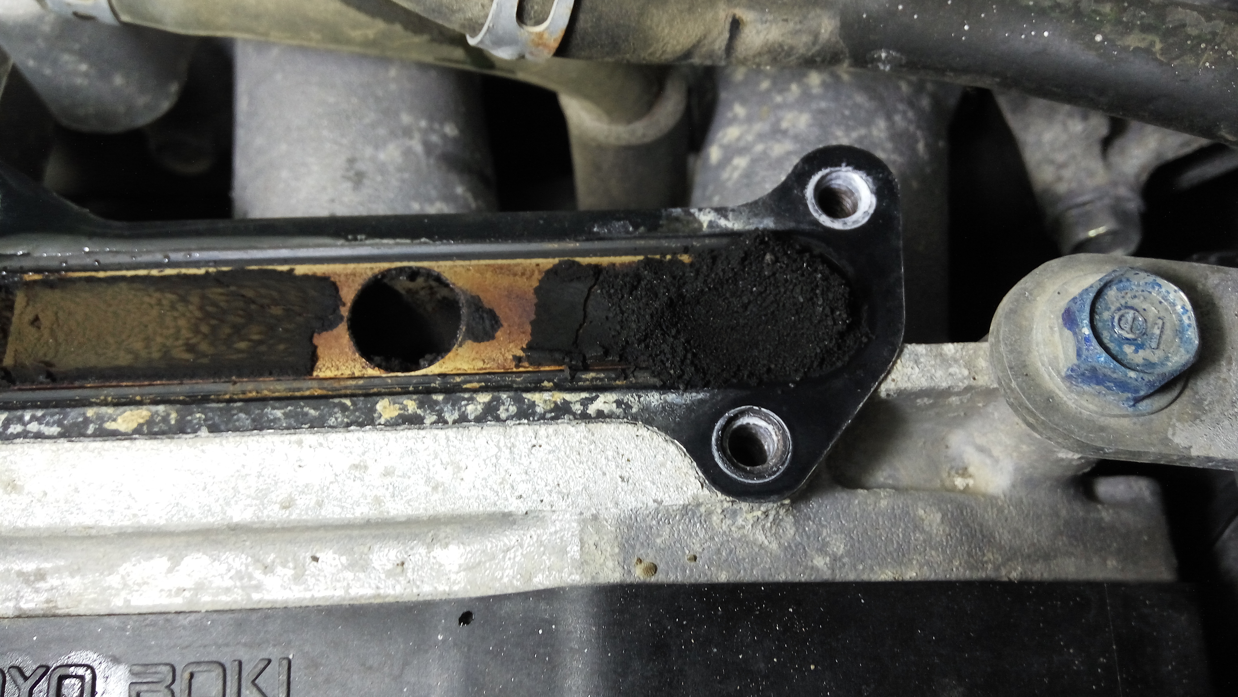

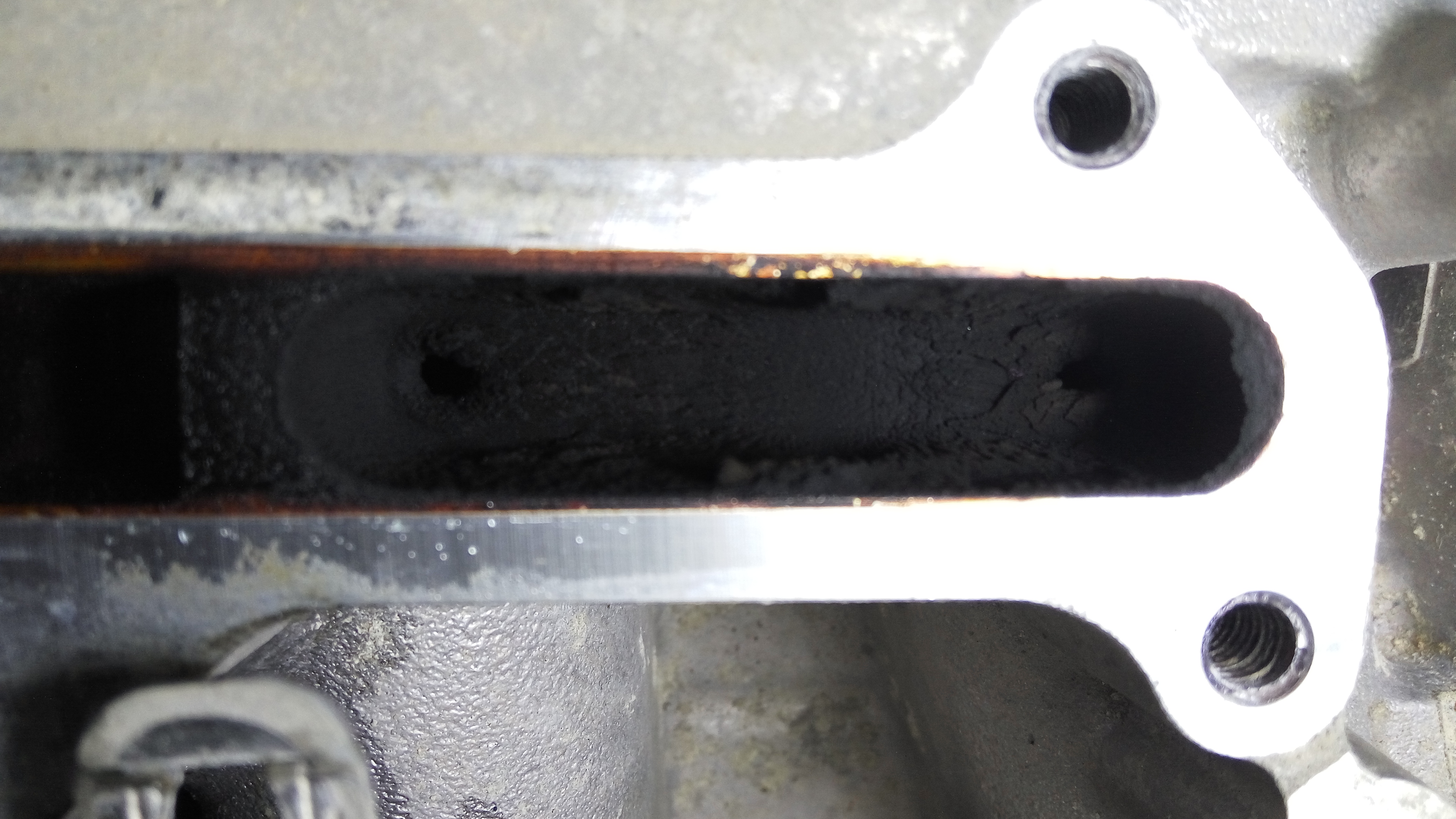

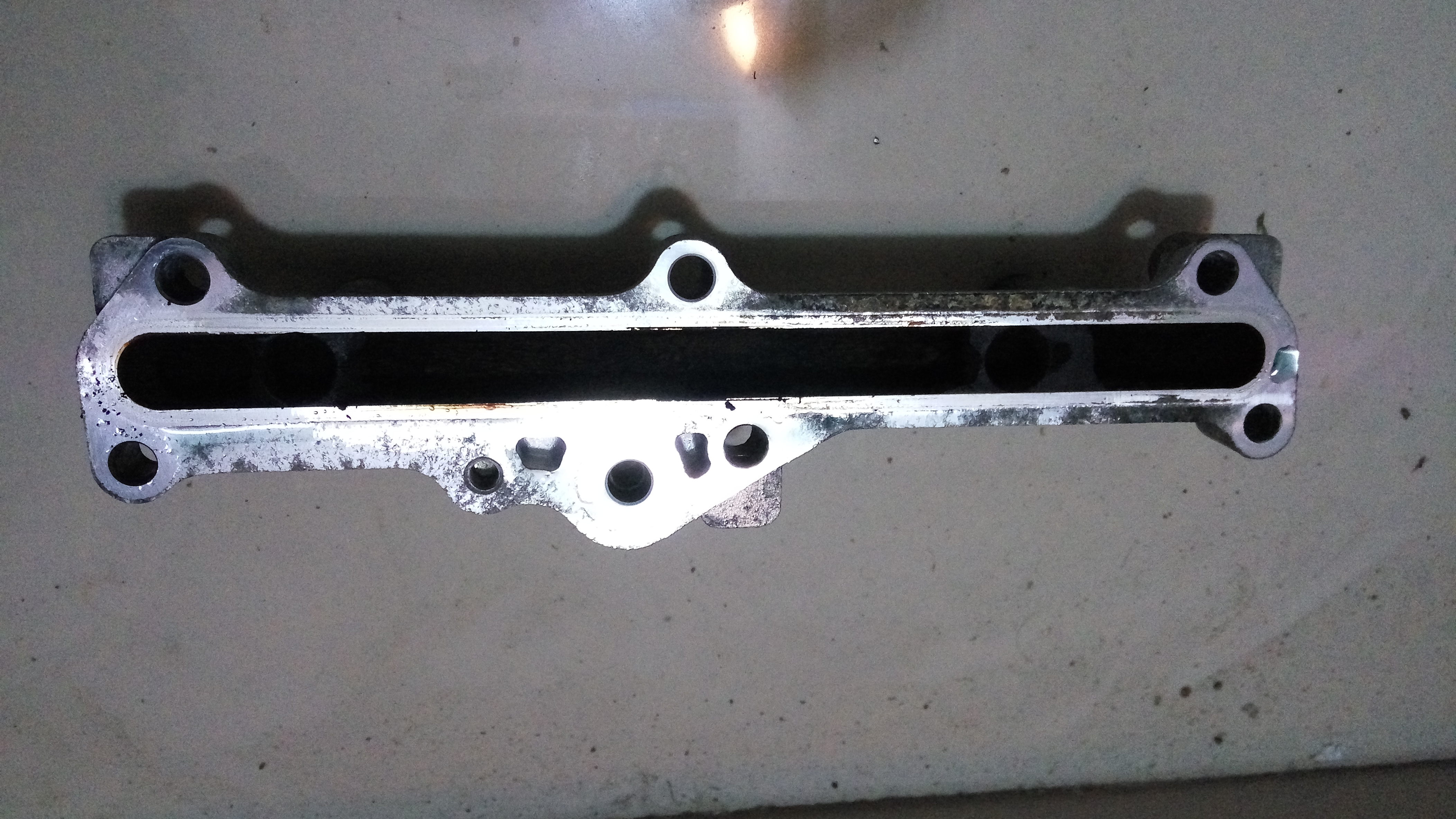

Old May 11, 2016 | 11:09 PM
vugar_1973's Avatar
Joined: Mar 2015
Posts: 8
almost all of them were blocked
Attached Thumbnails Knocking (detonation), HCH II, 2009-img_20160511_212457.jpg   Knocking (detonation), HCH II, 2009-img_20160511_212509.jpg   Knocking (detonation), HCH II, 2009-img_20160511_212524.jpg   Knocking (detonation), HCH II, 2009-img_20160511_212541.jpg   Knocking (detonation), HCH II, 2009-img_20160511_212548.jpg
Knocking (detonation), HCH II, 2009-img_20160511_212720.jpg   Knocking (detonation), HCH II, 2009-img_20160511_212812.jpg   Knocking (detonation), HCH II, 2009-img_20160511_212816.jpg
Old May 12, 2016 | 06:17 AM
Posts: 5,222
Whoa. I think yours was worse than mine with 220K miles.
