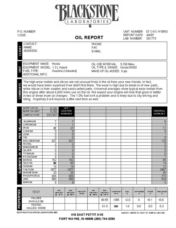

Default Should I do early A1 maintenance? Answer NO, because
It is best to let the first oil fill run for 9-10K miles. This is because there is still by-products of the manufacturing process in your engine that are still being flushed out. A road trip will be a good opportunity to finish the process of getting these by-products loose and suspended in the oil and caught by the filter.
While the A1 service does not stipulate an oil filter change, and oil filter is a cheap item, and should be replaced.
To give you an example of the condition of the oil in your car, here is the oil analysis I had performed on my cars initial fill when it was drained at 9200 miles.
