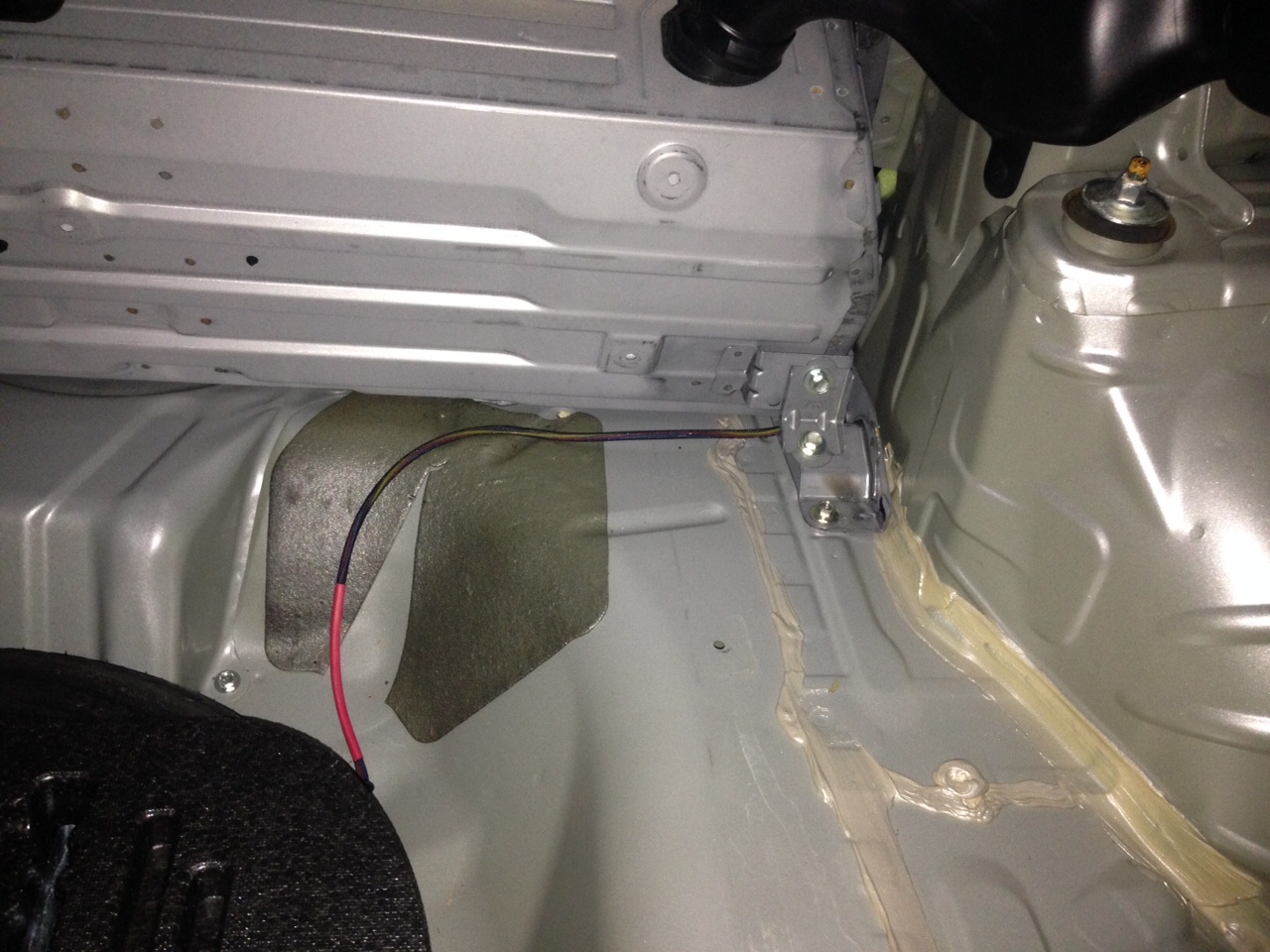

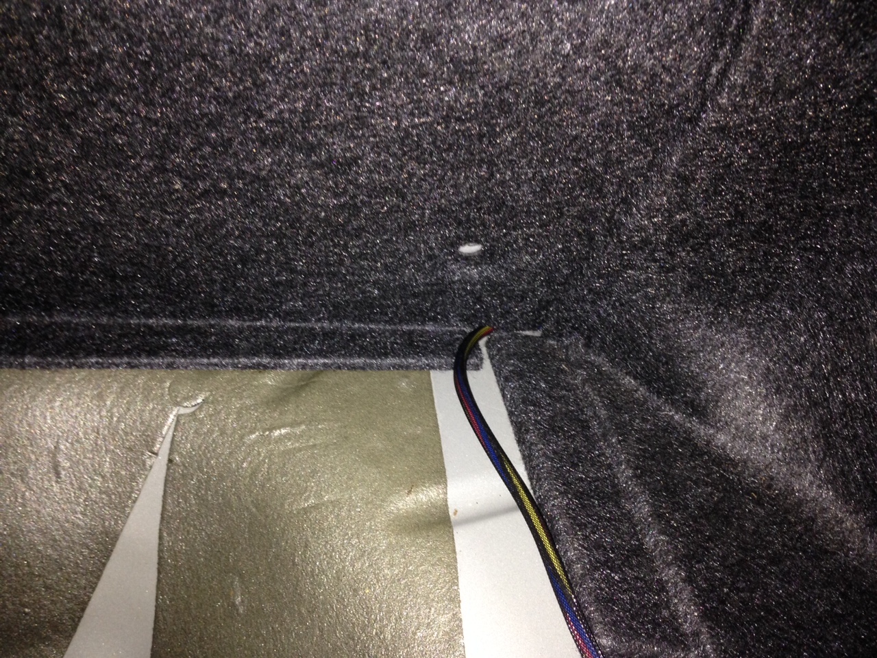

Hybrid Automotive harnesses installed. The most painful part was probably taking the car seat back in and out. Would have been easier with two people I think. Also I can see why people would just pull their battery out, installing the harness involved way more steps than pulling the battery out would have. However I also see the advantage, as the harness can be reused with little pain even if the battery is swapped in the future.
I found a nifty location to route the harness by unbolting this small L bracket in the trunk and routing the harness under it. Now I can leave the harness in the spare tire well OR tuck it in the corner under my all-weather trunk mat. The tire well could get wet sometimes so I will probably leave it behind the trunk mat.

I was surprised to learn that the ductwork is rather elaborate on that fan, and that it vents to one corner of the trunk.
The dash had 8 bars when I parked the car, and grid charger started at 176v but climbed to 178 within a few minutes. It's been about an hour and it is now 180V.
Nice job. Once you do it 2-3 times, it gets really easy. I can completely swap out a pack start-to-finish in barely 20 minutes. Good news is that if the grid charger does you little good, or if the results are short-lived, you've made an investment that will work for your next pack.
Attachment 2301
Attachment 2300
The ventilation design requires a good seal all the way around the cover. The fan vents to the trunk creating a vacuum in the IMA cavity. Air comes in from the rear deck vent through the battery pack... and any gaps you have between the cover and the flange. As long as you didn't deform it significantly or create too large a gap where you routed the wires, all should be well.
Your voltage peak will likely be north of 190V.
