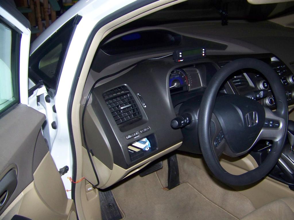

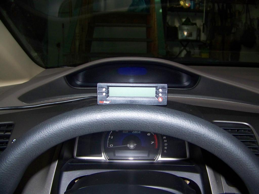

I mounted mine Directly in front of me at the start of the dash. In line with the main instruments.It comes with valcro for mounting. I had to really look for the female end to plug it in. It comes with good instructions on setting it up. I monitor LOD, Ignition, Water Temp. MPG. With the HCH it is good to keep lod below 50 and ign. over 30deg. Mine will go up to 38 deg. Great mpg here. H

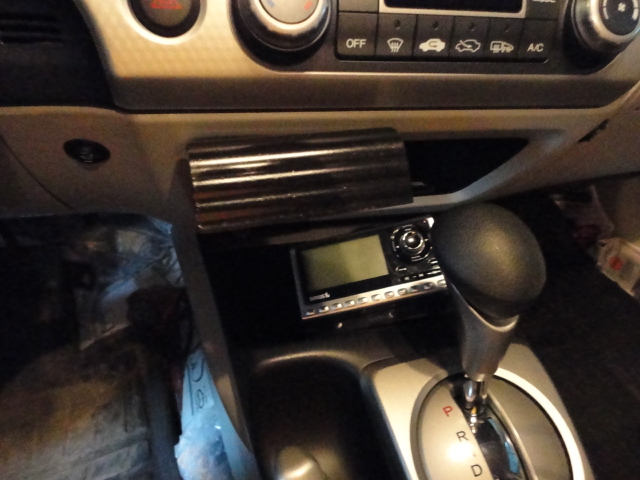

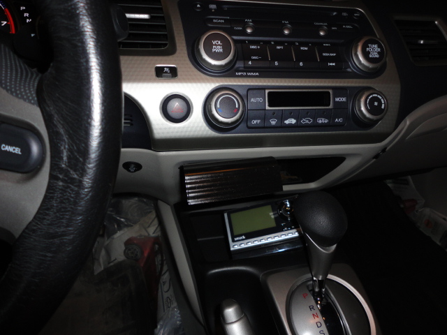

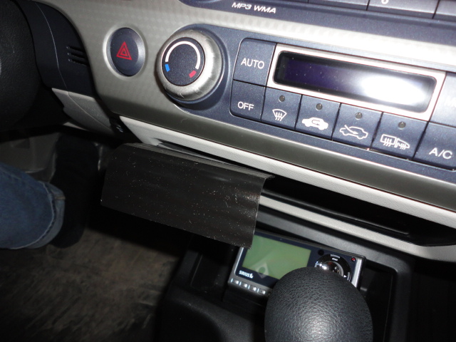

Pictured is my possible mounting unit position. The Velcro tape that comes with the tool will be applied to the face of the mounting unit. I have drilled a hole thru the removable panel directly under the HVAC controls to feed the wire from the OBD II connector to the unit in a hidden fashion (just like the wires for the satellite radio head are all hidden)....

New ScanGauge in the mail:  ideas for set-up wanted-100_2569.jpg Here goes. Hope it works Mike
New ScanGauge in the mail:  ideas for set-up wanted-100_2570.jpg
