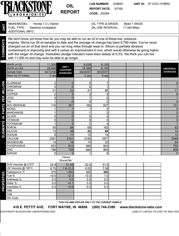

Default Oil change interval
Here are the results of Oil tests that I have had done on my HCHII since new. Notice that the first oil fill had quite a lot of material in it including a high amount of silicon left over from the engine block casting process. It is best to let the oil go to 0% or more on the maintenance minder to get as much of the stuff washed out from the manufacturing process as possible. As you can see from the report, the numbers came down to within specifications by the 3rd oil change. Settling on 10K intervals causes no harm to the engine.

These are great responses, the engineer in me loves the analysis of the oil changes!!!!
