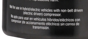

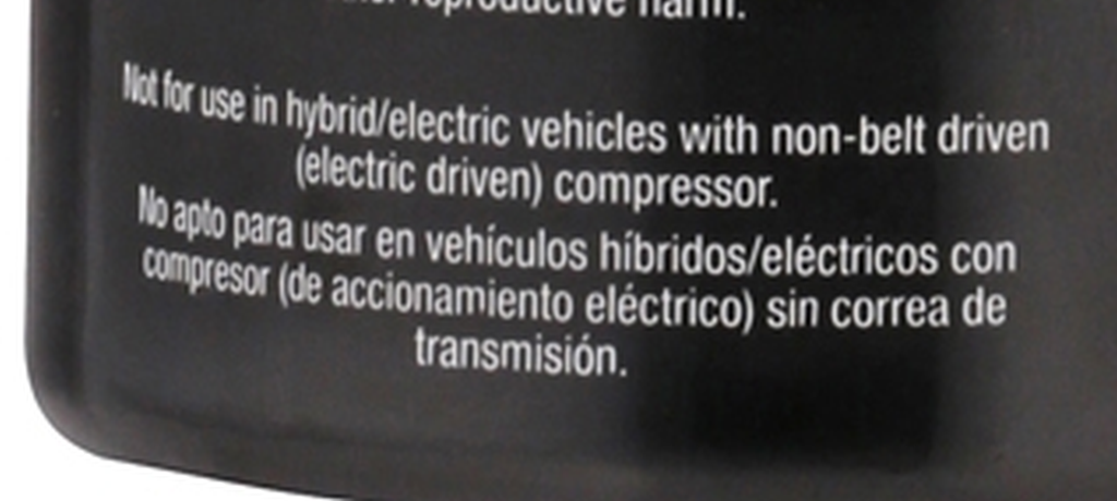

Old May 24, 2018 | 08:36 PM
Default Re: Just got 07 civic hybrid. Might be problematic ?
Note the warning in the finest print.
Most products like these have additives that render them unusable in a hybrid.
You likely need to have your A/C system evacuated and recharged by a competent facility. Your A/C compressor is a ticking time bomb unless you can confirm it was PURE R-134a.
