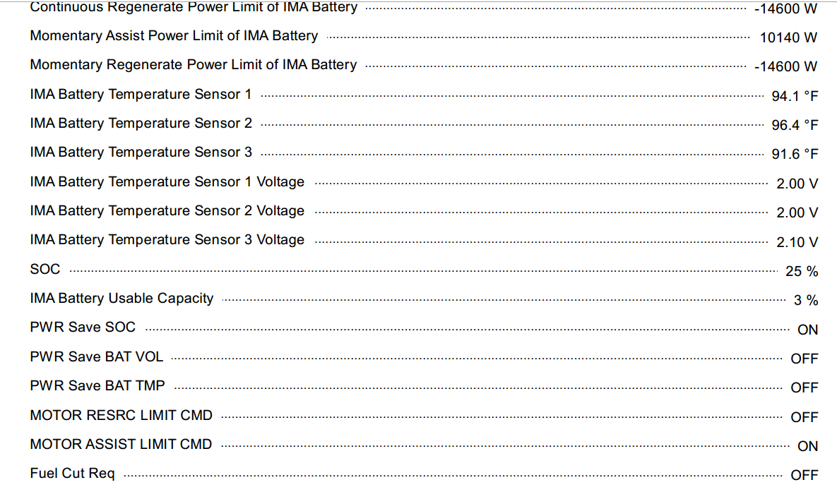

What was the capacity reported by HDS?
Low miles is an issue, but you barely qualify. Even as little as 10 miles/day is more than enough. Repeated sitting for days/weeks at a time is the killer.
I would encourage you to pursue a hybrid automotive Prolong reconditioning package the moment your warranty is up. Given that your recals are not impacting your mileage, and you haven't coded yet, there's a good change you could experience years of extended operation.

Thanks again, S Keith. We typically use the car pretty minimally, perhaps 5 miles 3 or 4 days per week, 10-15 maybe once a week. That's how we came up with 52K miles in 9 years.

---They had their own generic report, I'll ask if the service guy can give me the % from HDS.
Was shopping at pharmacy the other day, and I'm pleased I didn't need to buy a product labeled Prolong, but I suspect there's something different my car needs...
Late update: checked with service manager. He said that percentage on HDS is just the percentage of charge, like the green bars on my instrument panel. Presumably, I can take his word on this...he does seem like a good guy and straightforward.

Service manager is completely wrong. Being a "good guy" doesn't impart knowledge. He's probably just ignorant. MOST service "managers" or non-mechanic type service people (people who sell and schedule service), don't know squat beyond the tactics for upsell on unneeded or marginal services.
The only ones with any technical knowledge have been in the trenches and done the work - most haven't.
Attached is a sample printout from a recent diagnostic.
IMA Battery Usable Capacity: 3%
This car was hurting! Recals every 10-15 minutes and an IMA light every other day at least.
You paid for a diagnostic. You're entitled to that information even if they have to check it again to give it to you. It takes less than 5 minutes.

Wow...they had a fancy online diagnostic report (as well as a printout with the same information), but it was about as informative as a dashboard "idiot light," telling me just the general things a hands-on mechanic would find, e.g., needs new engine air filter, sometime will need a front journal bushing or whatever it's called.
The bad news is that I didn't get a report like the one you attach, good news is that they didn't charge me anything. I texted the service guy back and all I got was the more general info I posted before. I'm not sure if I'll get anything by pushing any further with him--but S Keith is suggesting either:
1) They didn't really do the HDS evaluation
or
2) They did and they're holding out on me
or
3) This guy really doesn't know much, even if he's personable
I'm really tempted to email him a copy of that printout you attached to your message, and ask for similar for me...that make sense?

Since you didn't pay anything for it, you're not entitled to it. I thought you paid $135. I missed the part where you said they didn't charge you.
That's a printout of the HDS Electric Powertrain / IMA DataList
