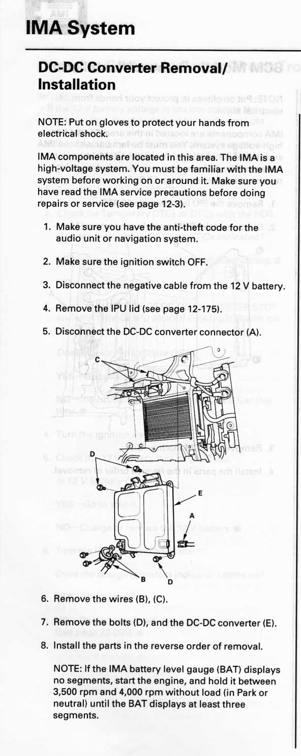

The recall is for an IMA hardware module, I don't believe that there was any software involved.
I had the IMA software done last year, and everything has been fine, overall mileage has been up about 2 MPG since the SW update.
Here is a more detailed explanation of the proceedure:
