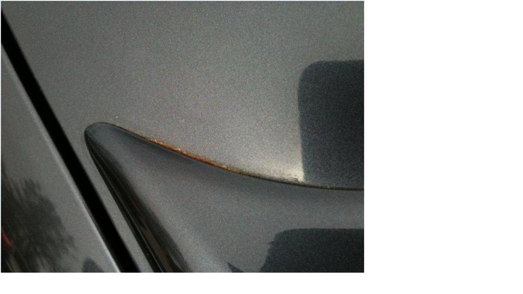

I've the same problem with my 07 civic. It usually drains out / evaporates after while so I haven't paid it much attention. It accumulates in the metal spare tire area, there isn't any rust so I'm assuming it's "normal".
My issues remaining since I've purchased the car new, abnormal tire wear still!! and now trunk rust due to the spoiler...which we had "repaired" by the dealer a while back.
