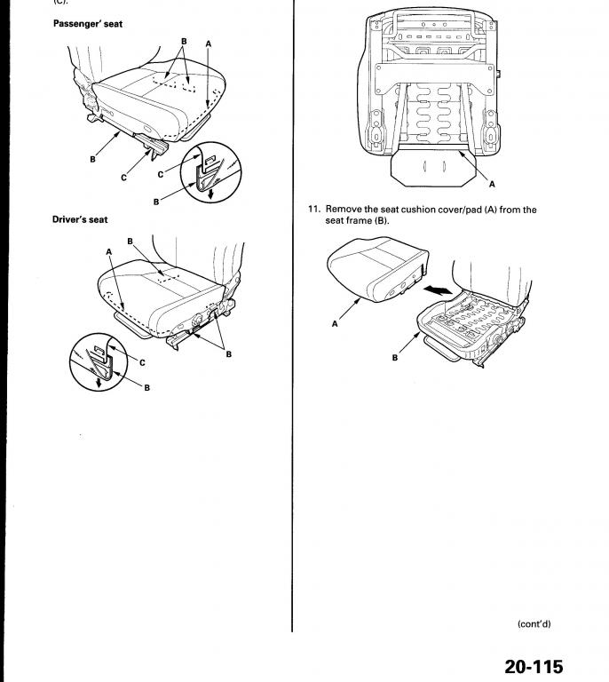

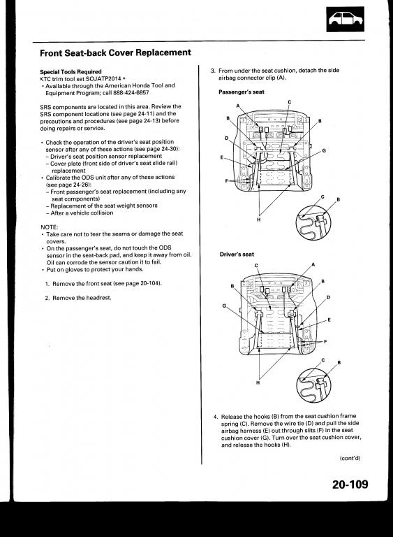

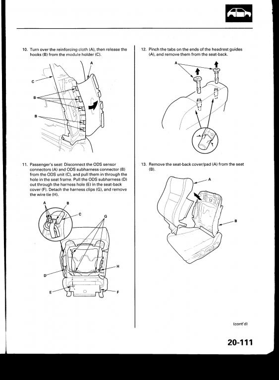

When I get the new seat heater kits, my plan will be to remove the seats, bring them into the shop and dis-assemble them to the point of being able to install the heating elements onto the foam cushions.
Here are the shop manual instructions for front seat dis-assembly for those interested in doing this upgrade:
Heated Seats, 2007 HCH-2006_service_manual_20-109.jpgHeated Seats, 2007 HCH-2006_service_manual_20-110.jpgHeated Seats, 2007 HCH-2006_service_manual_20-111.jpgHeated Seats, 2007 HCH-2006_service_manual_20-112.jpgHeated Seats, 2007 HCH-2006_service_manual_20-113.jpg
See next post for remaining pages....

...and the rest of the instructions.....
