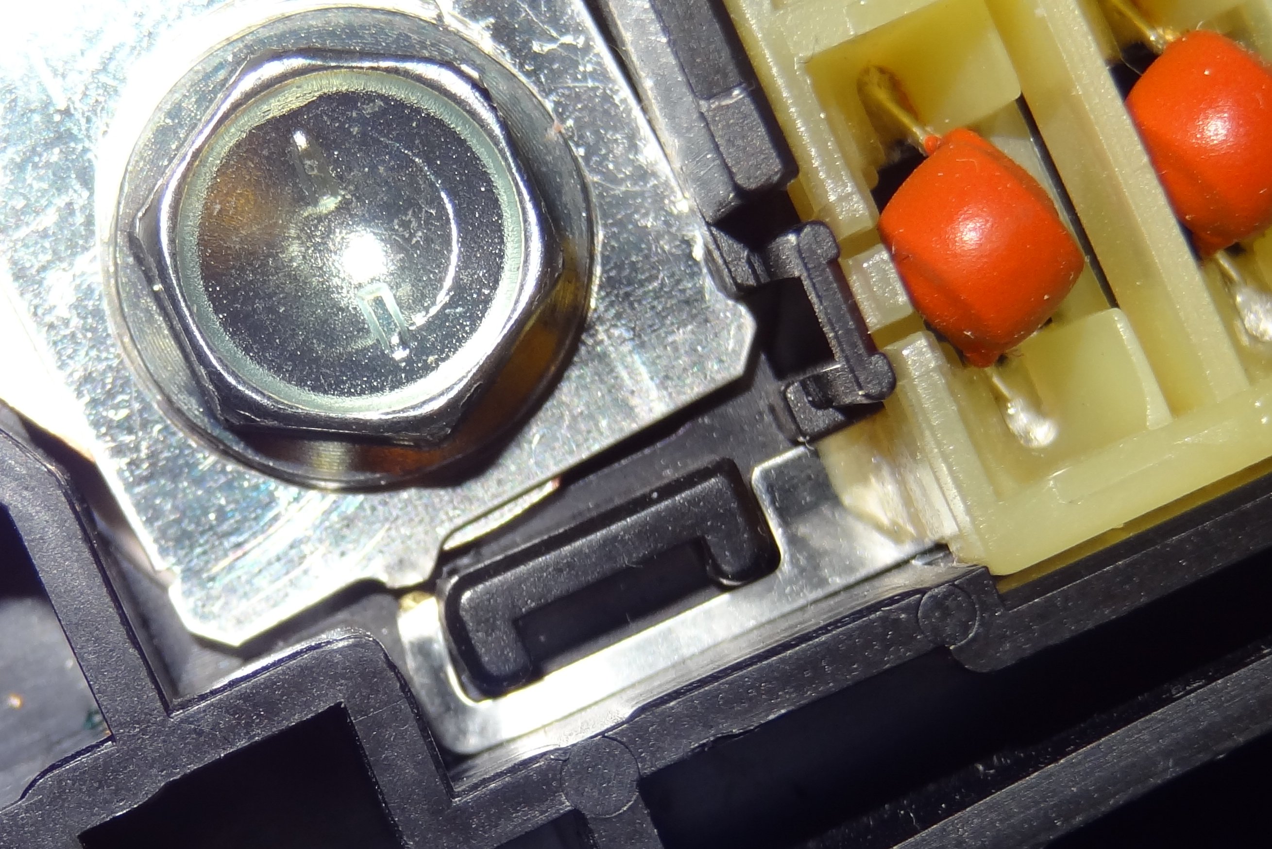

So I started measuring voltages of the cells and preparing a rig to individually balance the cells. However, once I put a load (10 mA) on the cells I found that the voltage dropped down to nearly 2V. I do not believe that the cells are that bad and have a feeling that it has to do with the orange bugger inline with the cell. Does anyone know what that component is actually called? I was thinking about discharging and charging the cells at 1A if I could get this setup to work.
Attached Thumbnails HCH II BCM Cable Balance-2293d1435205614-ima-dead-after-reconditioning-dsc08251.jpg

Yes, those prohibit you from doing what you want. They are there as a safety in the event of a harness short. They massively increase resistance as current increases. I don't know what they're called.
You need to understand there is a 99.9% change that every penny and second you expend on this effort are going to be in vain. As you've experienced with "several" replacement batteries, these things are garbage. I currently have 11 in my house, and I can't build a single good one from that pool.
The harness wires are very thin gauge. Even if those weren't there to prohibit current, I wouldn't run any significant current through them.

The orange things aren't relevant. They must be bypassed. But here you go anyway:
http://99mpg.com/blog/batteries/theptcthermistors/
There's no meaningful way to use the harness to charge/discharge the subpacks, nor is there a way to use the harness to charge multiple sticks unless you're skipping a pin - and even then, the thermistors will thwart you. Keep in mind that the pins are effectively voltage taps, not isolated circuits. On subpack 1, the (-) terminal is also the (+) terminal of subpack 2.

Thank you for the link. Positive Temperature Coefficient thermistors do make sense and what I was afraid of. Even though they are only voltage taps you could still charge/discharge the individual subpacks as long as all of your charger had an isolated ground.
