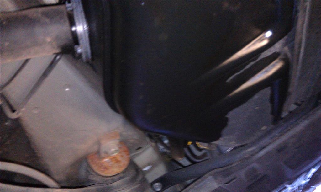

I had the fuel tank leak just a couple months ago on my 2008 HCH. I drove the car to work on a Friday and noticed nothing that morning. Early Saturday morning my wife went into the kitchen to make coffee and told me that she smelled gas. I also have my Corvette and a gas generator in the same garage. Initially I thought it was the generator leaking that caused the smell. Process of elimination by sniff test led me to the left rear wheel of the Honda. I put it in the other garage on ramps and found the leak where the fuel filler neck joins the gas tank.
On Monday I took it to the local Honda dealer and got a call later that day that the entire fuel tank would have to be replaced and they were back ordered nation-wide. It would be at least three weeks to get one in. I bought the car used in Jan 2011 with 16K miles and the 3 year warranty ran out in May 2011. I was looking at $600 for the replacement. I told them to keep the car on their lot as I would rather have it blow up there than in my garage. The service advisor worked it out with Honda America to cover it under warranty (still only had 25K miles at that point) with a $100 deductible.
While I was waiting, I posted the problem on NHTSA's webiste and had been emailing back and forth with an engineer from DOT.GOV who seemed very interested in the situation.
Just over 3 weeks later the service advisor called me to let me know it was ready to pick up, but that Honda had just issued the extended warranty that morning and I owed nothing.
Even though there was a strong gas smell in my garage, there was no gas puddling on the floor, but the bottom of the tank had a large wet spot on it. I took pictures that I can post if anyone would like to see them.

Old Jan 4, 2012 | 08:21 PM

The first pic shows where the leak occurs at the joint of the filler neck and the tank. Even though it looks like there is a seal/o-ring at the joint, the entire tank and filler neck are one unit and everything has to be replaced. There is no repair.
The second pic shows how wet the bottom of the tank got from the leak.
