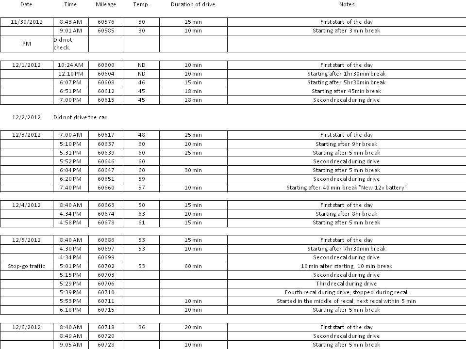

Okay, I have been tracking recals these past few days. I changed my 12v on Dec. 3rd. No let up in recals. Is my hybrid battery dying? Based on the opinions of experts out there, how long would you think it may last (IMA light turns on) considering the frequency of recals and the fact that my overall mpg is down from 41-42 to 33? Thanks.
I'm not sure the light coming on is the only criterion that Honda will use to decide the battery is dead. There are also whatever codes are read when they hookup to the engine computer (maybe).
I took anywhere from 1-2 years before I had the light come on, and it was only on for one day. The next day only the engine light came on and after that neither. It is possible Honda turned it off while we wait for the battery to be shipped, but I don't know for sure.
Your log on 12/3/12 and 12/5/12 pretty much mirrors my typical driving times, mileage, and recal frequency for the past 90k miles (2.5 years) for me on my 06 HCH2. However, I still maintain mid-40's to low-50's mpg. Your 9mpg drop and low FE is very unusual and I would get that checked out. If your battery checks out ok, you may have to alter your driving patterns like I did. Good luck.
