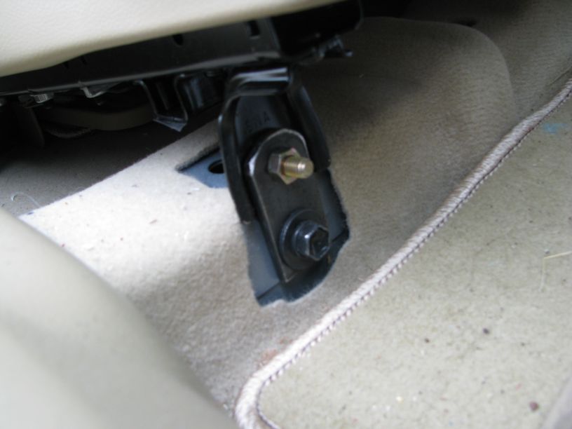

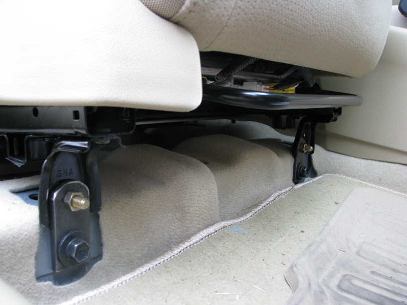

All you need to do to get rake on the front seat, is to put an inch-anda-half spacer uner the front of the seat. We did a 6,000 mile trip in our HCH this summer, and the only thing lacking was some lumbar support.

Fairly simple: I bought a 3-foot length of 1/4x 1" steel stock at Home Depot. I cut off two pieces (for each seat) about 2 1/2 inches, drilled two 3/8" holes 1 1/2 inch apart in each, and rounded the edges for safe handling. I removed the front seat bolts, fastened each piece of steel with the seat bolt, and used another bolt to fasten the seat to the top hole in the steel piece. Same for the second seat bolt.

It makes a big difference by raising the front seat. Now I get great thigh support. Just wish it had some better lumbar support. We are still thinking about getting a RECARO seat. As far as safety goes, the 1/4-inch steel has a lot more strength than the body pan the seat bolt attaches to. A machine shop could probably make such brackets for a reasonable price.

Any chance we could see a picture of what you've done?

I took a couple of pictures. Let's see if it works!

Thank you Per!!! I took your advise and raised the front of the seats up 1 1/4". I cannot believe the change it made for comfort. It also gets your knee cap away from the e-brake, so two items are eliminated. My only complaints with this car to date are gone! noflash hurry and make the change! You will have a happy face for along time? You wont have to rent a mini van for your next trip! lt is a very simple fix. I used 1/4" alum., got to keep the wieght down! Thanks again Per, H
