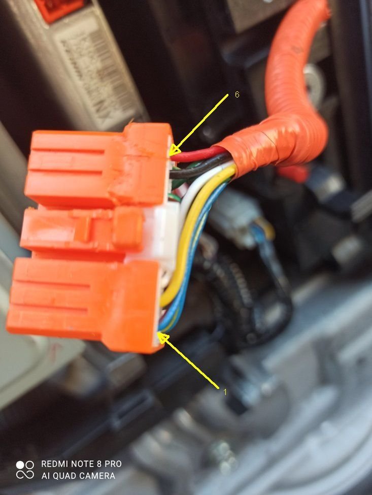

Resting voltage of 180-182V is very high.
Use the voltmeter to probe the connecter and check the 11 block voltages (you check on the WIRE side of the connector, i.e., where the wires go into the connector, not the open ends):
Use accuracy of XX.XXV, e.g., 15.72V
Voltages should be very close to each other.

hiI will not want to appear incompetent but there is in my eyes a problem, when you test 2 by 2 it is missing in the indication terminals 14 and 13 color code,which pine am I testing ?

Please refer to your picture. See pins 1 and 6:
Each red line indicates a measurement between connected wires.:
