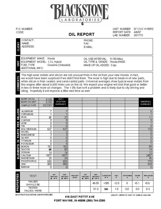

If you do decide to change the oil filter at every 20K miles, that is fine. I would advise you to remove the filter at 10K miles and drain out to old oil from it, then replace it back.
The first oil drain will have the highest concentration of solid materials of any oil change that the car will ever have. This is primarily residue from the manufacturing process. If you look at the oil analysis of my HCHII below, notice how high the elements found are in the first oil sample, and how they go down from there. This is why I always change the oil and the filter on the first oil drain, and after that go to the 20K filter change interval.
