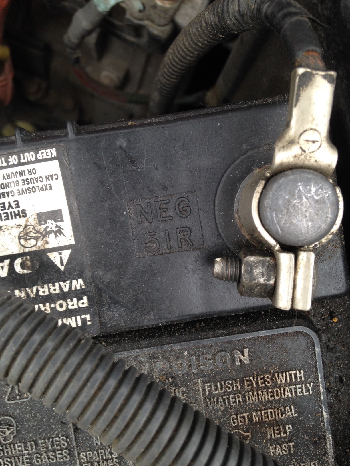

Looks like I already have a 51R in there. I'm taking it to battery warehouse tomorrow morning so they can properly test it.

I took it to Battery Warehouse on Saturday. Their Tech said the battery is still good but if I don't run the car every day I could experience some trouble starting it in the winter. Their price was $98 for a 51R and it comes with a 5 year warranty.

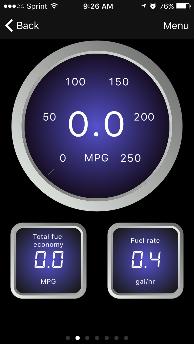

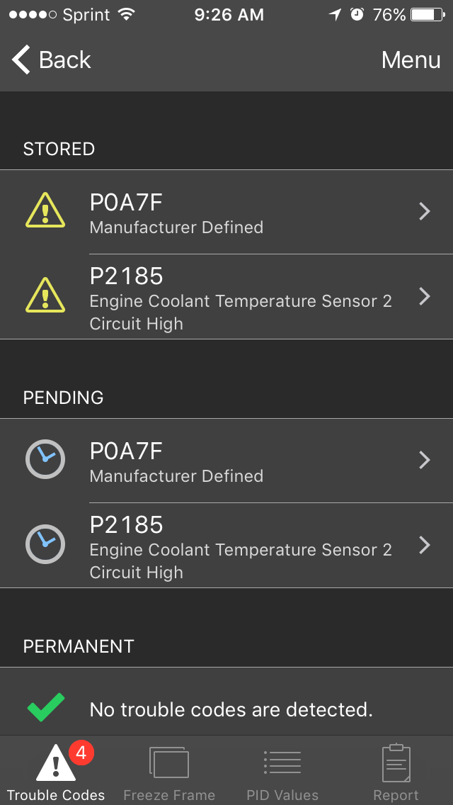

Got my
Veepeak Mini WiFi OBD II OBD2 Scanner Veepeak Mini WiFi OBD II OBD2 Scanner
from Amazon this week. Also, bought the App https://www.obdsoftware.net/software/obdfusion for $9.99. It has great customizable Dashboards and CEL diagnosis. Able to clear codes after fixes also. I've used it to monitor my engine battery voltage and haven't seen any issues since my car turned off while driving. It was also designed in Gibsonia, PA, 20 min from my hometown.
Attached Thumbnails 06 Civic Hybrid shuts down while driving-dashboard-1.png   06 Civic Hybrid shuts down while driving-dashboard-2.png   06 Civic Hybrid shuts down while driving-dashboard-3.png
Old Oct 21, 2015 | 07:56 AM
Default Re: 06 Civic Hybrid shuts down while driving
Very nice. What about that coolant temp sensor? What does your coolant temp show?

When I had it inspected at Honda last week they diagnosed the check engine light for free because of a few recalls. He said the garage tech looked at it and one off the pins in the sensor is broken. I refused the replacement at that time. I did order a
Honda Temp Sensor Honda Temp Sensor
on Amazon because I had a $10 off coupon and it was free shipping. The coolant temp is still being read though. I'm going to replace it next week to see if the code clears.
Old Oct 21, 2015 | 10:23 AM
good deal. A messed up coolant sensor can wreak havoc on the fuel management system, particularly if it's reading low.
