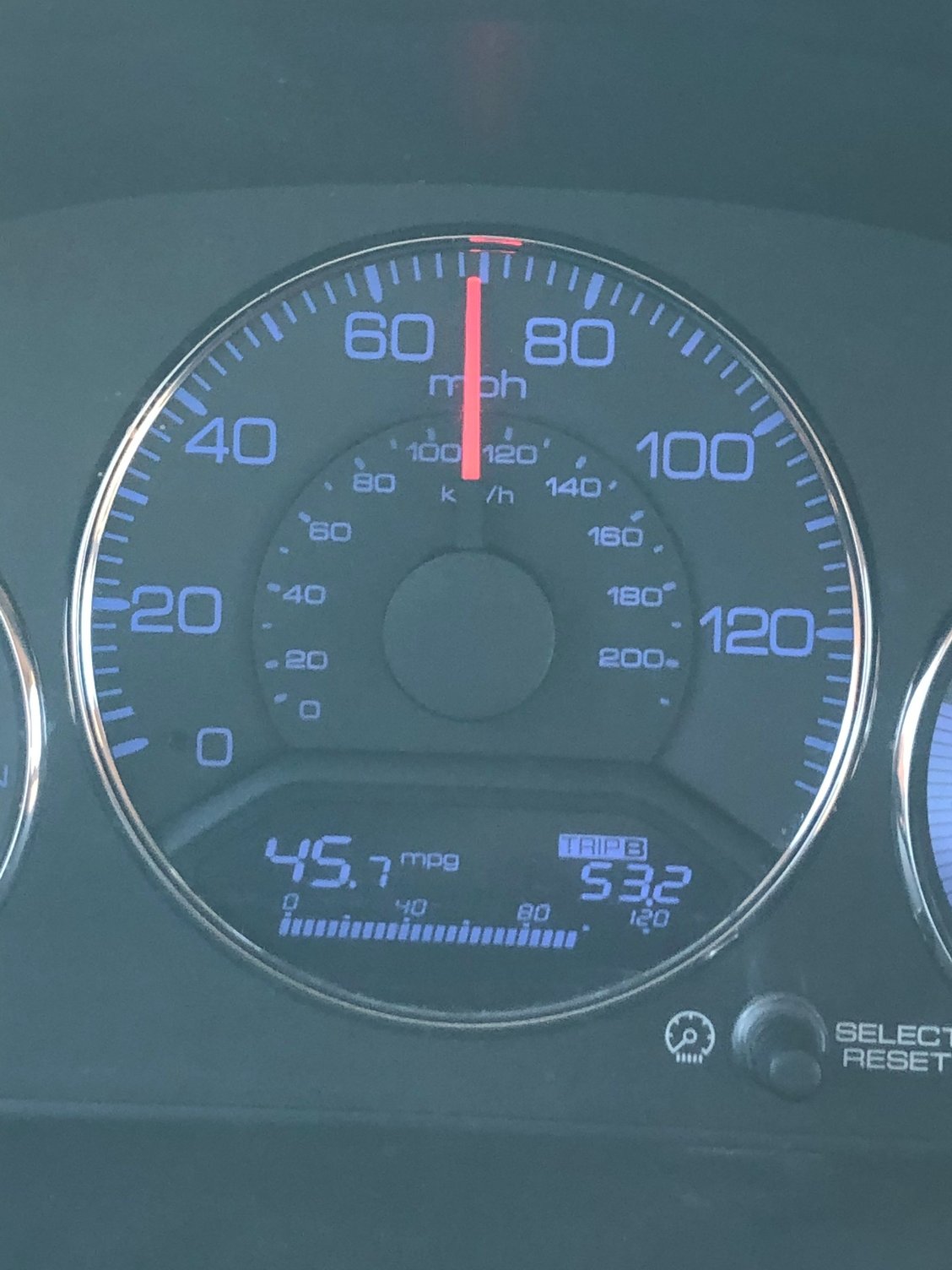

Default Re: Purchasing 05 hybrid manual w bad ima *update*
*Update*
Installed a new 12v battery - aired up a low tire and car drove home 60 miles w zero issues and a charging ima - all functions work.
I think the co worker I have had a failing aged 12v along w he bought a refurbished 12v battery and it duplicated the poor 12v operation.
I will see if there is an overnight draw or change in the meantime .
