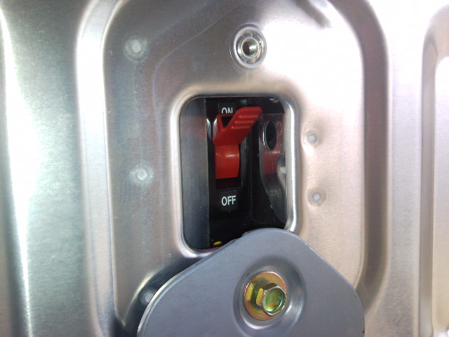

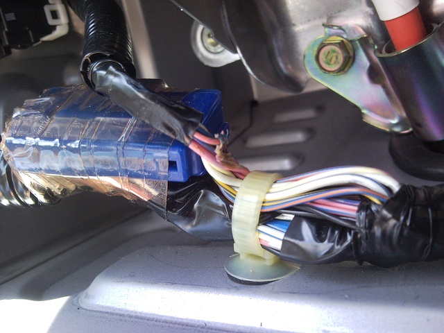

'04 HCH, 122,000 miles MT, A/C all year round (except for about a week and half in late Dec.) 5 days a week, 100 miles+ a day
I have been recovering from surgery, car sat for about 2 weeks. First day back in and IMA light came on about 20 miles down the road, check engine light was already on from P0420 code (you guys in Cal. are so lucky to have M/M), that code comes and goes, will be on for about 2 days then go off for 3 or 4 weeks sometimes less. More about this later, checked for new codes, got a bunch, P1433, P1575, and P1600. Looked online and found you guys.
Hey All!
Dealer told me $2800. A lot of money. So, I took mine apart and found one of my wire harnesses had been damaged. Oh yeah, I did get this used, 24K on it then. I am replacing the harness first ($150), no broken wires but 3 wires were chaffed more than half way through and close enough to be touching. Going to have my 12v checked, now that I have read this board (thanks).
I just wanted to let ya'll know that there is a switch on the battery (under the small plastic cover right behind your back seat, in the middle)(2 bolts for the seats, 2 bolts for the cover), when I turned it off, I believe I actually got better MPG, it felt like the IMA was no longer engaging for the charge state. So there was no drag on the engine, like I usually felt when I let off the gas. IMA light stays on though. My MPG has been about 38 for the last 5-6 months, went to 41 after about 100 miles. Not too scientific, but I will let you know if I see any change long term.
Failed IMA Battery Owners!-cover.jpgFailed IMA Battery Owners!-switch.jpgFailed IMA Battery Owners!-switch1.jpgFailed IMA Battery Owners!-battery.jpg
I did have a software update about 16 months ago when my P0420, engine check light first came on. Dealer had my car for about 4 hours before they told me they fixed it with software update. Oh by the way, no charge for that! Yeah thanks!
Man, I wish I had know you guys back then!!!!!!
I have only been on this for a few days now. I have a few days till the harness comes from CA.
Does anyone know why they are not warranting the replacement battery for 8/80K, I was told my new one (if I get it) would only have 3/36K. That is kind of messed up.
If any of you have done/or are planning to do anything "legally" to remedy this IMA situation please let me know and count me in.
