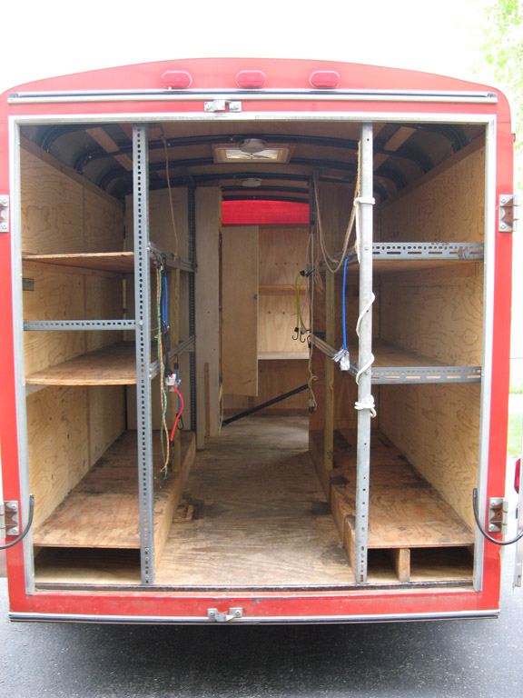

It's been awhile since I pulled anything (like 20 years to be exact) and the
last thing I pulled was a 1000lb boat.
Finally hooked up the Boy Scout trailer to the truck (the reason I
gave the wife as to why the Tahoe ). Once I get up to
35-40, starts to buck. If I let off the gas, the bucking diminishes.
What the heck is going on?
Trailer (pics below) is a double axle trailer and it's 15' (to the tip of
the hitch). I'd guess it's about 3500-4500lbs with all the gear in it.
The dealer hooked up a Tekonsha P-3 Trailer Proportional Brake Controller
for me and I think I've set it correctly.
I was pulling on level even ground (smooth roads) and can't understand
the bucking. The trans got to around 160 (never higher) and I stayed in
drive the whole way.
I know it's not going to pull like my little boat diod way back when, but I didn't expect this at all!
Any ideas??
Edit - It is very windy today and I was bucking on open roads. Perhaps I'll try it
in M4. It almost seems like it's slipping in and out of overdrive.
