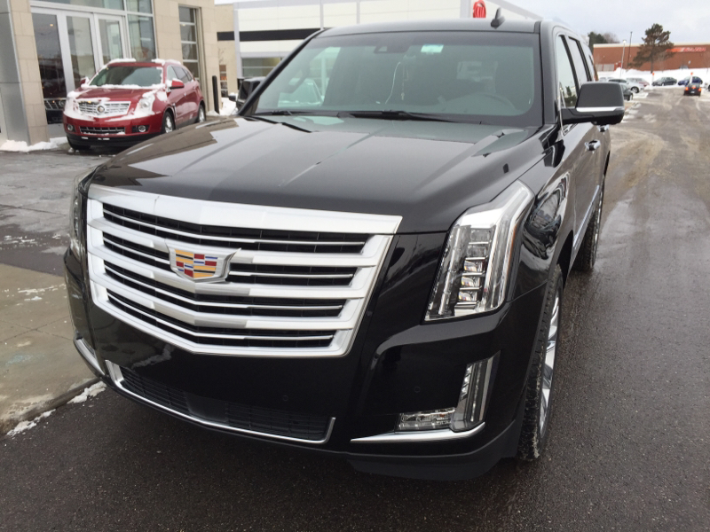

Sad day:(. Traded my beloved 2009 hybrid escalade
Old Feb 4, 2015 | 12:01 PM
Originally Posted by hybrid-theory
What were your main reasons for trading it in? Were you getting concerned about the higher mileage? I have looked at the new ones, and yes they are nice(and new) but not like "Wow, gotta have" nicer. PS, I can't imagine living anywhere where it snows-lol, I don't even drive my Tahoe when it rains, I have probably driven it less than 6 times in the rain.(I have a rainy day car).
Not concerned about high mileage because I know it will last. New battery, new tires, new brakes, etc and only mobil 1 EP used. But my rate of driving, once it hits 200k miles I think the trade in will even substantially drop if it can even be traded. Oh new MRC shocks and air compressor too!
Plus the driver aids on the new one.

Xpel just installed
Attached Thumbnails Sad day:(. Traded my beloved 2009 hybrid escalade-image-1981872459.jpg

Very nice upgrade.

Thanks! Not the same mileage though
