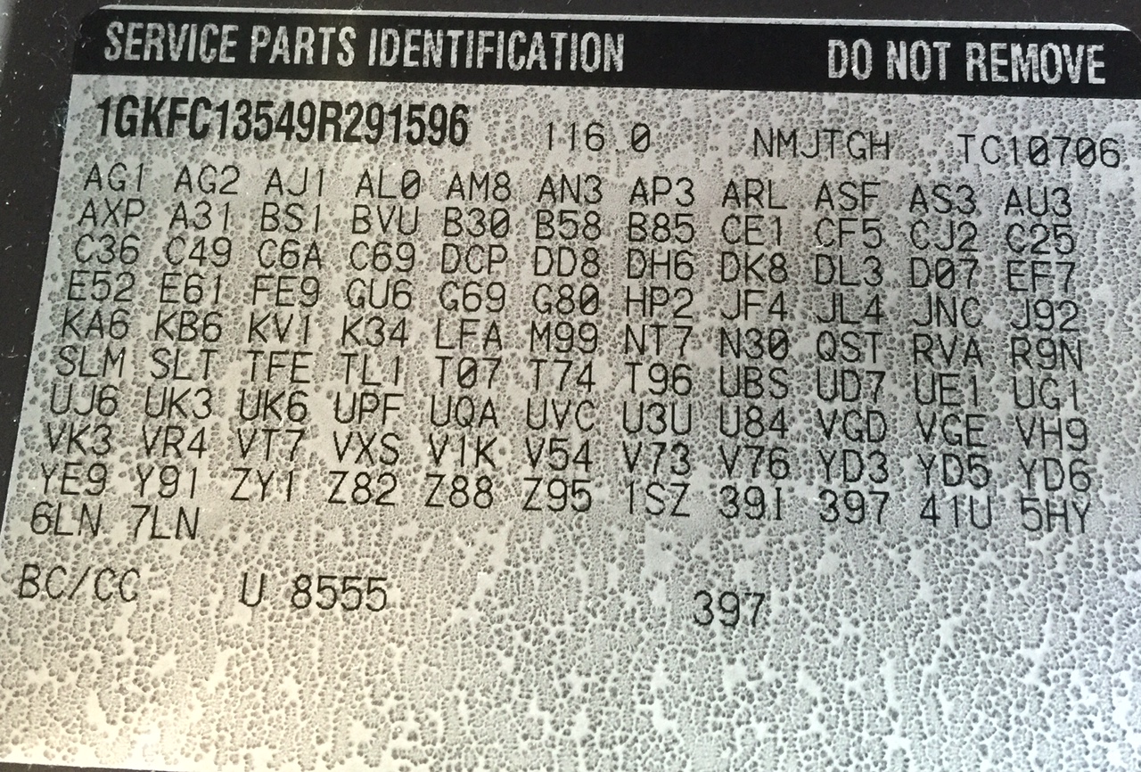

Question on new front struts. I have a 2009 Denali Hybrid with 22" GMC rims. (VIN 1GKFC13549R291596).
How do I know if my car has the Z55 with Electronic suspension with magenetic ride control or not? (GM Part number 19300066)
I called Monroe shocks Tech Support and they had me look at the "Service Parts Sticker" in my glovebox (pic attached) and since there was no Z55 and there was a Z95, then they said I have a Z95 Electronic Suspension with magentic ride control (for which they do not provide struts for).

I would go to dealer for install. You have to program it as well hence dealer.
